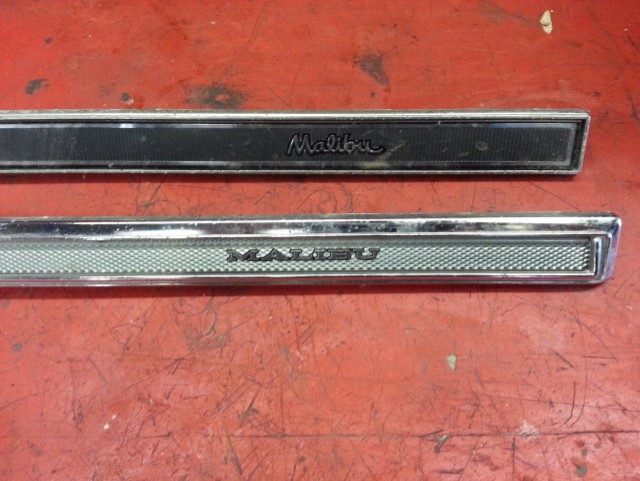

Another oddball. Our 69 had what appears to be a 68 Malibu dash plaque on it and can be seen in the original photos. The photo is what I took off a 69 parts car (upper) and what was on the Yenko (lower) which I believe to be a 68. Ours is a March 69 car so not early by any stretch. Has anyone ever seen this in their COPO as well? This car what totally unmolested as far as interior and chassis goes so in no way do I think someone changed it out in the first year of its life.

Originally Posted by SS427 View Post
Another oddball. Our 69 had what appears to be a 68 Malibu dash plaque on it and can be seen in the original photos. The next photo is what I took off a 69 parts car (upper) and what was on the Yenko (lower) which I believe to be a 68. Ours is a March 69 car so not early by any stretch. Has anyone ever seen this in their COPO as well? This car what totally unmolested as far as interior and chassis goes so in no way do I think someone changed it out in the first year of its life.
Dan Vasic has a black 1969 shell restored and by memory it had the 68 dash trim piece.
Maybe 5 years ago.... let’s test my memory of tiny useless details :-)
Ryan W31

Old 01-03-2019, 06:46 PM
camarojoe's Avatar
Join Date: Sep 2003
Posts: 5,307
Thanks: 239
Thanked 273 Times in 121 Posts
There is a white 69 Yenko Chevelle I’ve seen that also has the 68 Malibu dash emblem. Definitely were a few 69’s they came this way for whatever reason.

  #217
Old 01-03-2019, 07:19 PM
21superboat 21superboat is offline
Join Date: Feb 2007
Location: Long island NY
Posts: 41
Thanked 5 Times in 2 Posts
If i had to choose based on appearance and correctness a 69 malibu dash plate would be the way to go. Who knows how a 68 plate wound up in there but i wouldnt put it back unless there are other documented 69 yenkos confirmed being delivered this way
Thank you for your input but that is not how I operate. One of the things I have prided myself on over all the years is restoring these cars how they were found and built (assuming they were original) and not how the majority of them were built. Case in point is Dana's 68 Yenko with no SS emblems on the fenders. One of a very few that came that way and was restored accordingly as this is part of the Yenko history and I have no intention of changing that history.
Jim S's 69 Forest Green Yenko had no 427 emblems anywhere, no hood stripes and the stripes did not say Yenko SC on the body stripes. I wanted to restore the car that way but he won out. Again, changing history is not my intent so regardless if this is not the correct plaque, that is what came on the car and what will be going back on. I have heard from a couple people already that state they have seen 69's with this plaque.

  #220
Old 01-03-2019, 08:30 PM
Posts: 10,354
Thanks: 3,241
Thanked 4,716 Times in 1,164 Posts
Originally Posted by mockingbird812 View Post
Rick I know this Restoration is keeping you very busy but you asked about wheel cylinders a while back and I responded that the correct wheel cylinder for 69 Chevelle SS is 15/16”. I believe 7/8” is correct for a 70 Chevelle SS. I just restored my original wheel cylinders a few months back and confirmed from my photos that they are in fact 15/16. Good luck
Yes you did and thank you again for that. At the same time almost every other person I have checked with said their car had the 7/8" so I was confused and thought I would put it out in public to see what everyone else had. Ditto on the rear brake hose. Seems to me I asked Dan Vasic this question as well based on how many he has had apart. I have been busy so my apologies for not mentioning yours and my conversation. I need to start writing things down! LOL
