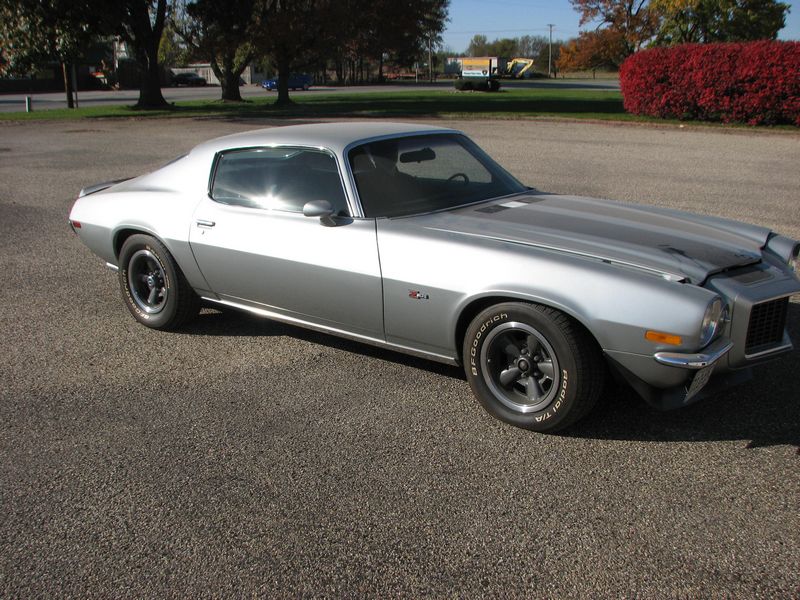

Yes, it will be at next years MCACN. Thank you for the compliments. Here is a before shot of the Z. Sweet car for sure and another M22, 4.10 car.
