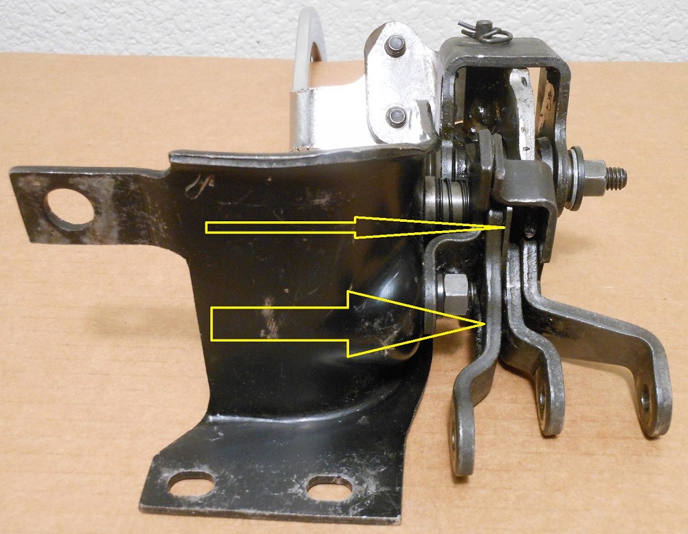

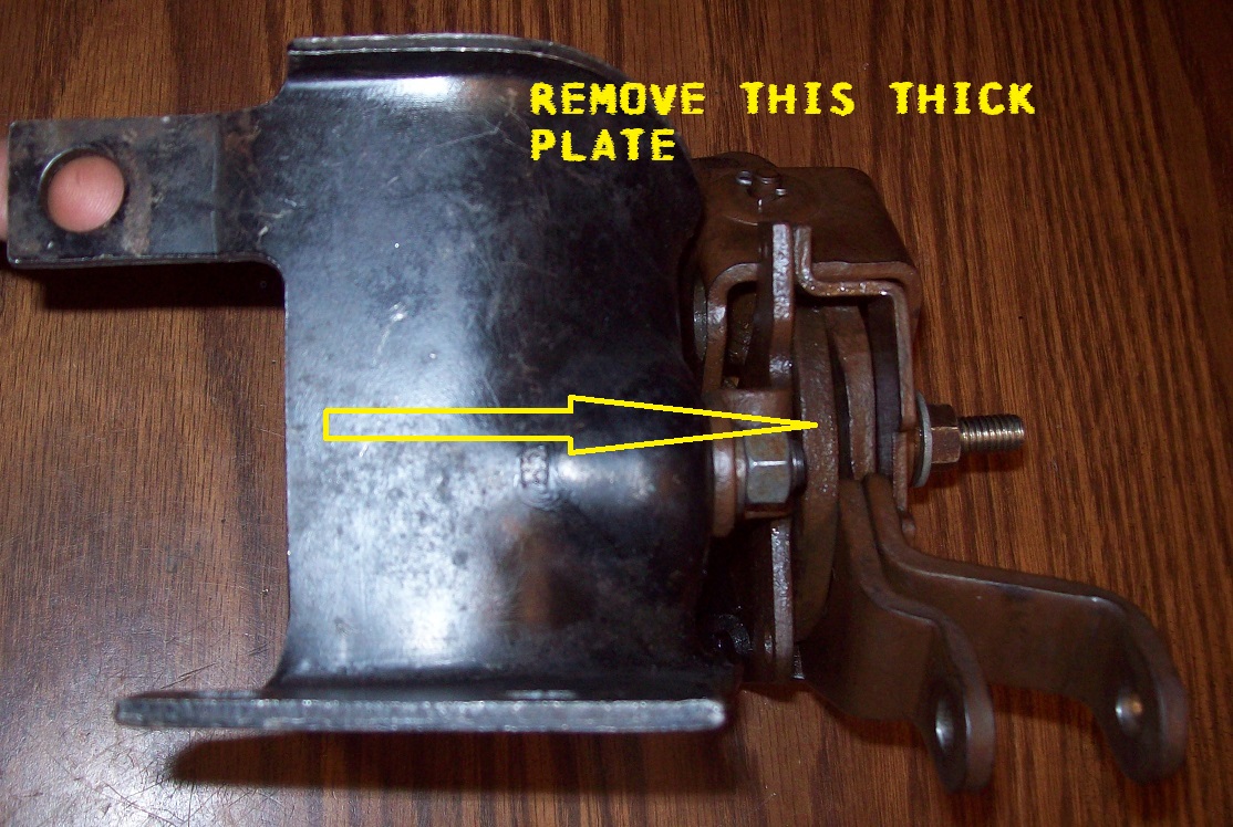

Originally Posted by jl8z28 View Post
I have the same one what parts do i need to change
You simply remove the Delete Thick plate and replace it with the Third Lever that faces the Bracket and you also need to insert a shim in between the two levers in that center area.
I'll add a photo so you better understand.
