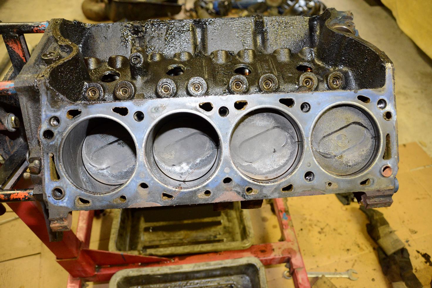

Got the 7/16 x 5 inch bolts this morning and got the engine on the stand. Boy is this thing big and heavy. I started the disassembly and have already broken two 3/4" Craftsman sockets trying to pull the heads off. Those are some torqued down bolts! I'll need to use an impact rated socket tomorrow (after I buy one).
There is a ton of gunk inside that engine. When you touch it it crumbles more than smears. So it looks like I'll need to completely take this apart and hot tank the block to get all the goo out. That's what comes from 47 years of cold starts and limited driving. When I drained the oil (that only had 400 miles on it) - it was like black coal coming out of the drain plug. Can't wait to see what the oil analysis will say.

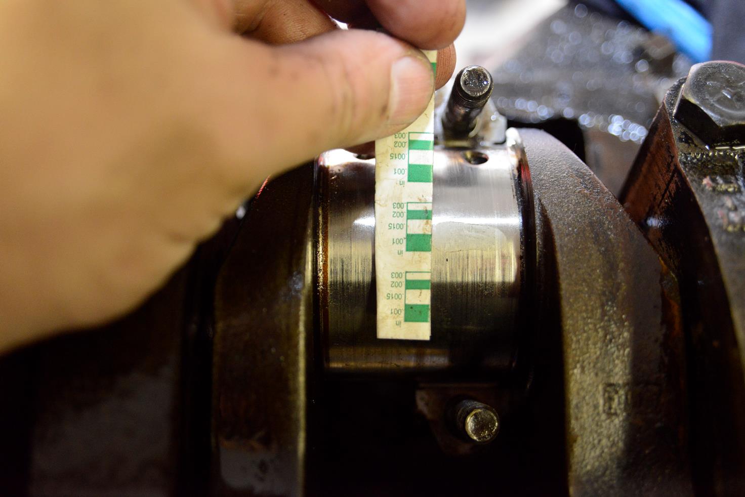

I pulled the first main cap to check the bearings. The crank looked great but the bearing was all copper. The rod bearing I checked looked fine and still had all its material intact. I'll Plastigage each one before I pull it all apart in the coming days. I like to know exactly how things were wearing in case I just go with a polish and re-bearing at STD size.
Interesting thing I am learning about Fords - they number the cylinders 1 through 4 on the passenger side and 5 through 8 on the driver's side. Not 1-3-5-7 and 2-4-6-8 like a GM. All the rods are number stamped.

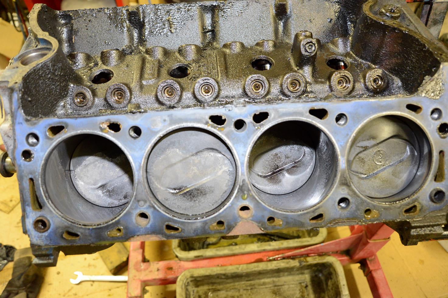

I got the engine fully apart today. Almost got a hernia too, breaking loose those $%#@*& head bolts with my old trusty diesel mechanic 3/4" drive ratchet and a pipe on the end of it.

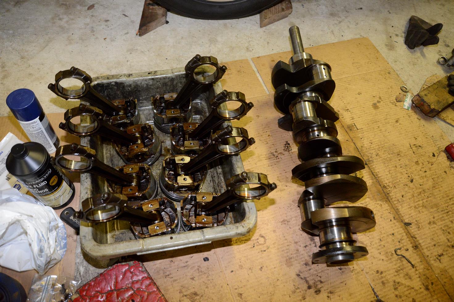

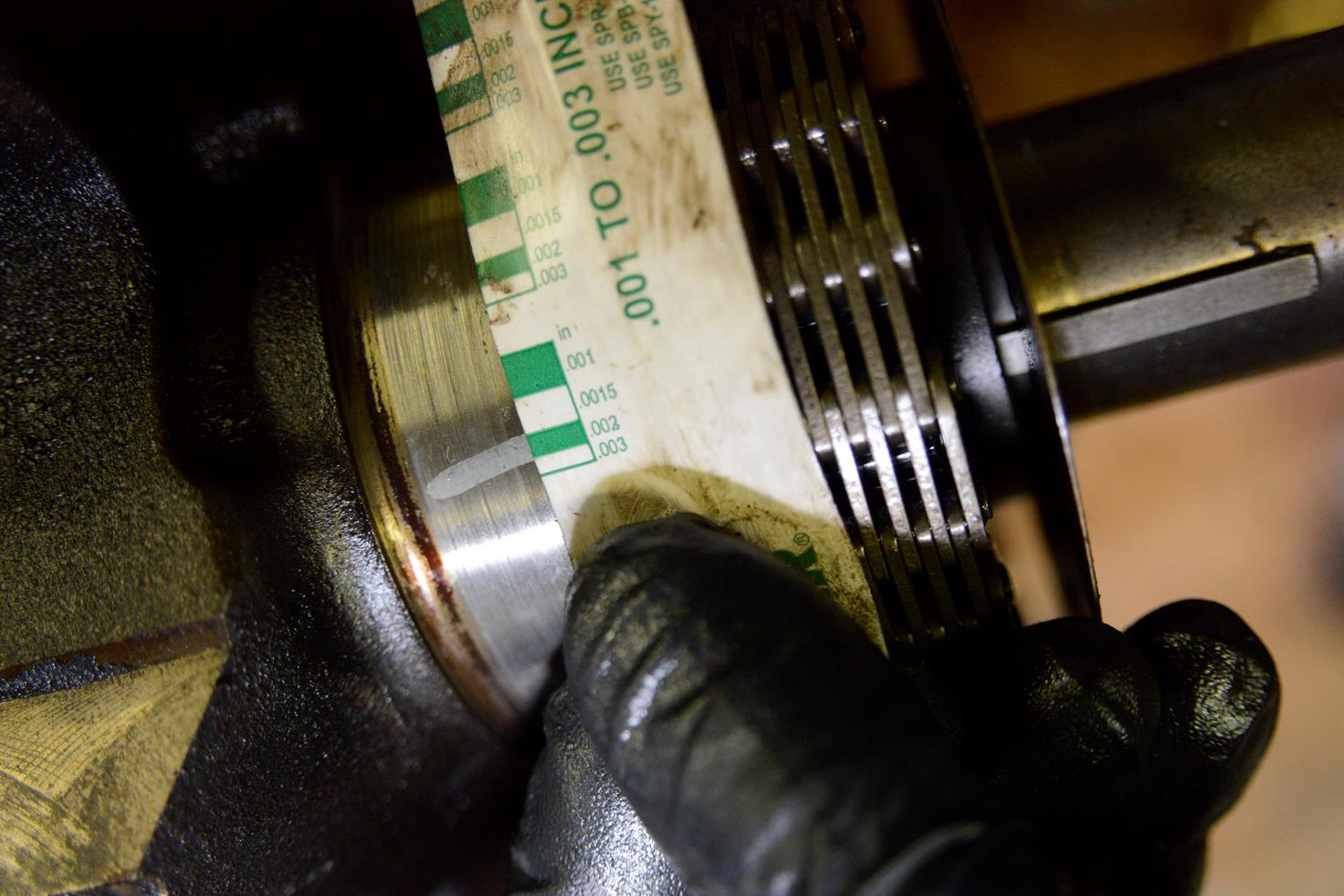

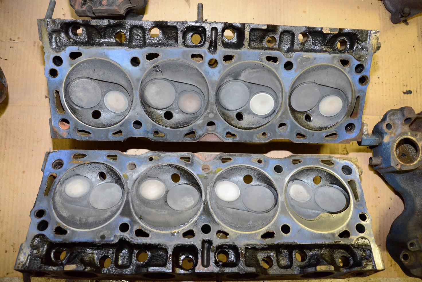

The rod bearings looked decent but you can see the small copper wear pattern on the tops of each rod bearing - most likely from my Dad running the 10-1/5 to 1 compression engine on 87 octane for the random times he was driving it over the past couple decades. OUCH! All the mains were at the copper layer top and bottom. The crank itself looked very nice. I guess the original Ford Clevite bearings did their job and sacrificed themselves instead of the crank journals.
I Plastigaged a couple bearings and the rods looked to be really tight: much tighter than the minimum 001. line on the paper. The mains came in at .002.
I had to borrow a ridge reamer from the local autoparts store to get the minor ridge out of the tops of the cylinders so as not to damage anything coming out.

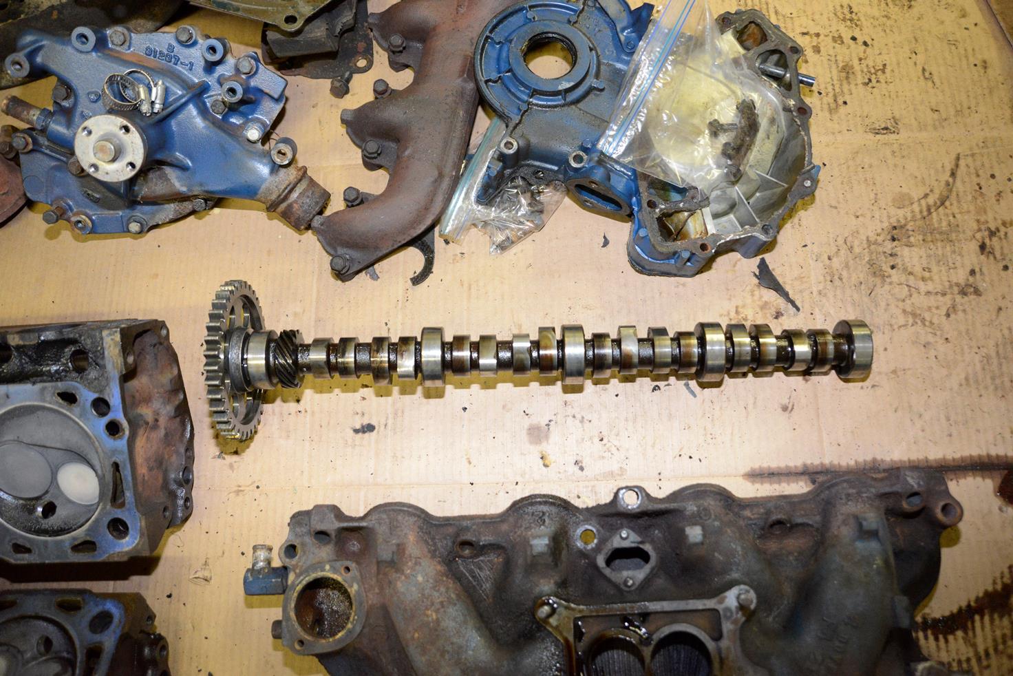

The lifters has a varnish buildup and were sticking in their bores at the top of their travel so I just left them there and turned the block over and then pulled the camshaft out while the lifters hung upside-down. I then pushed them back down their bores and they slid out nicely from underneath without scratching the lifter bores at all. The original camshaft looked decent but there was varnish on the surface in spots. All the bottoms of the lifters were evenly worn with a hint of concave wear.
The combustion chambers on the heads looked very nice, as did the pistons. Not much carbon buildup at all.

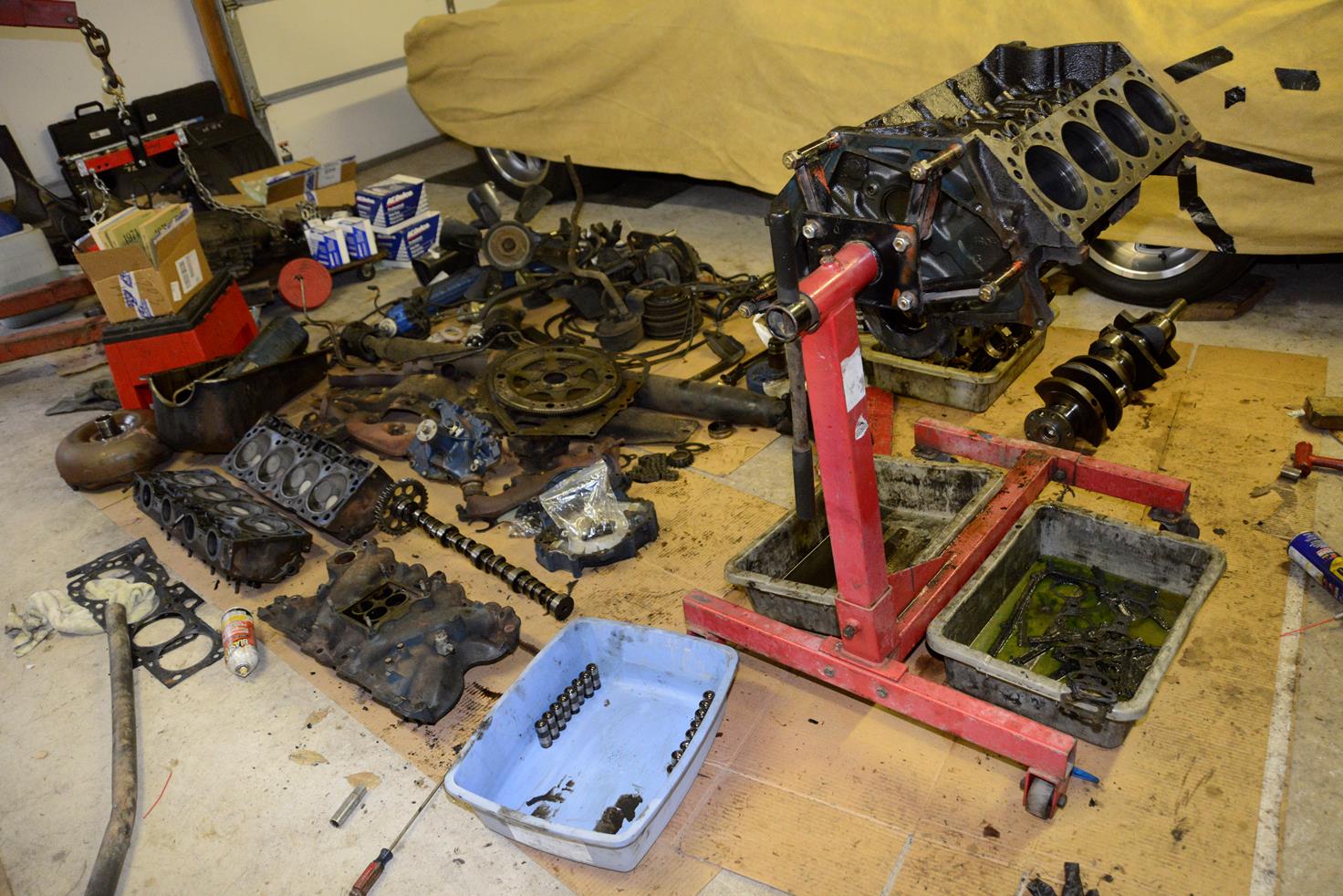

And here's the giant assemblage of parts as of this evening.
