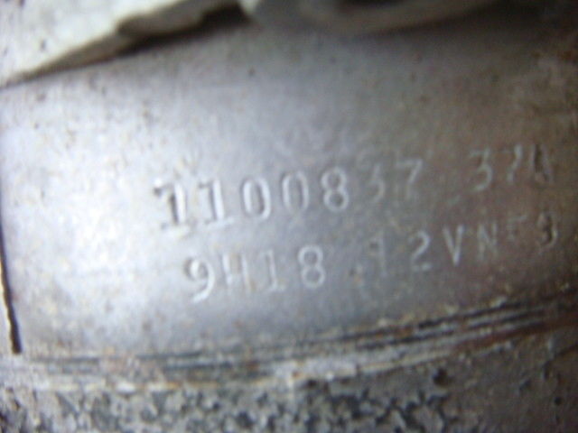

Seller lists this as a 70 Z/28 alternator but date code is 9H18. $350 with free shipping.

That stamping? Maybe it was a 834? Not sure why the 7 has a X through it?
I don't see it ?

I have a 9H6 and a 9H25 date saved. That one looks like a stamper to me JMO.

https://www.ebay.com/itm/69-CHEVELLE...UAAOSwFmRbgZlL
When I clicked on the OPs link it went to the auction above^^ Sorry for the mistake.

August 18 too early for a 70Z for sure.

In my opinion Mikey is right. It looks like it was altered to look like an 837 and I have never seen any August of 69 dated 837's besides 9H6 and 9H25. That 7 does not look good...
