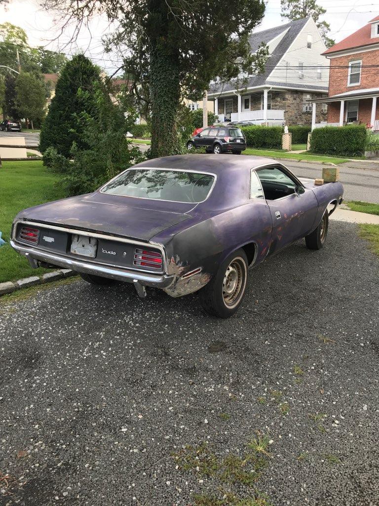

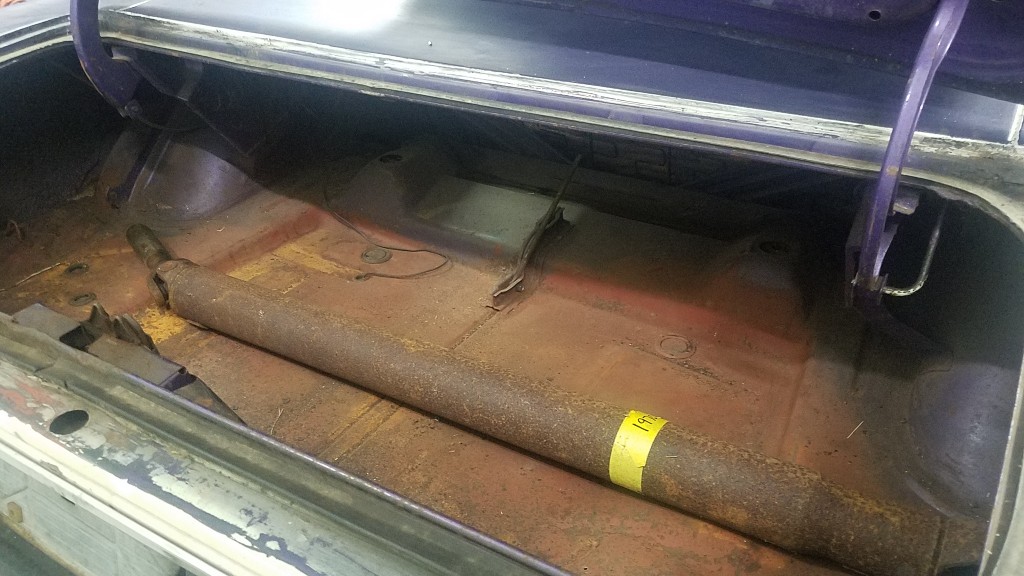

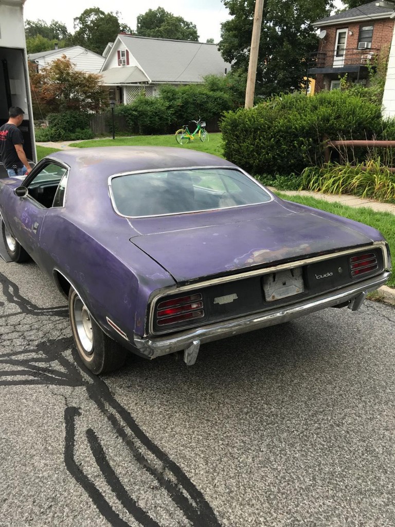

Jim, yeah, good info. I talked to Barry a few times. His site is a great source of info. No original spare in there, which leads to debate on the wheels. And the spare tire mounting stud is long gone which would have indicated if it were space saver or steel wheel based on its mounting positon. But..... two 14" Ralleye wheels on the car are dated 3-23-70 and Crusty's SPD is 4-30-70, so good chance they are original to the car. Speedo gear is for 3.23 F70x14, which adds to the 14" conclusion. I do have past owner info I can contact and see if they may recall. Second owner had the car from mid seventies on, so he might know. But James is a pretty good sleuth and think he'd have already tried to figure it out and his conclusion is 14" Ralleyes with full sized spare. But I'll keep digging! I'm thinking it's 14" Ralleye as well.

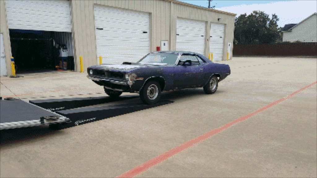

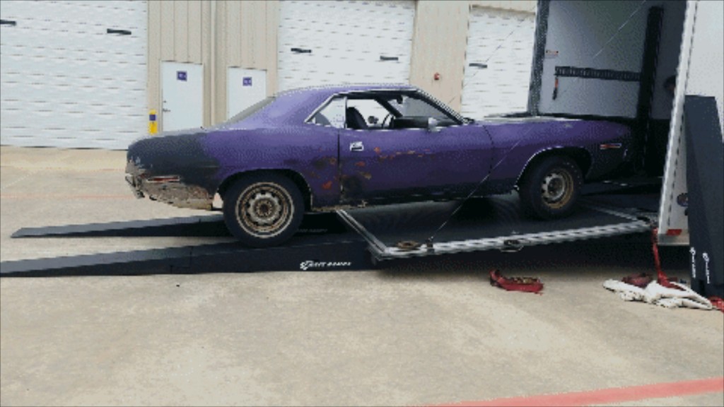

She's on her way here! Picked up last night and should be rolling to TX tomorrow or Saturday!!! And so it begins.....
Cheers
Dave

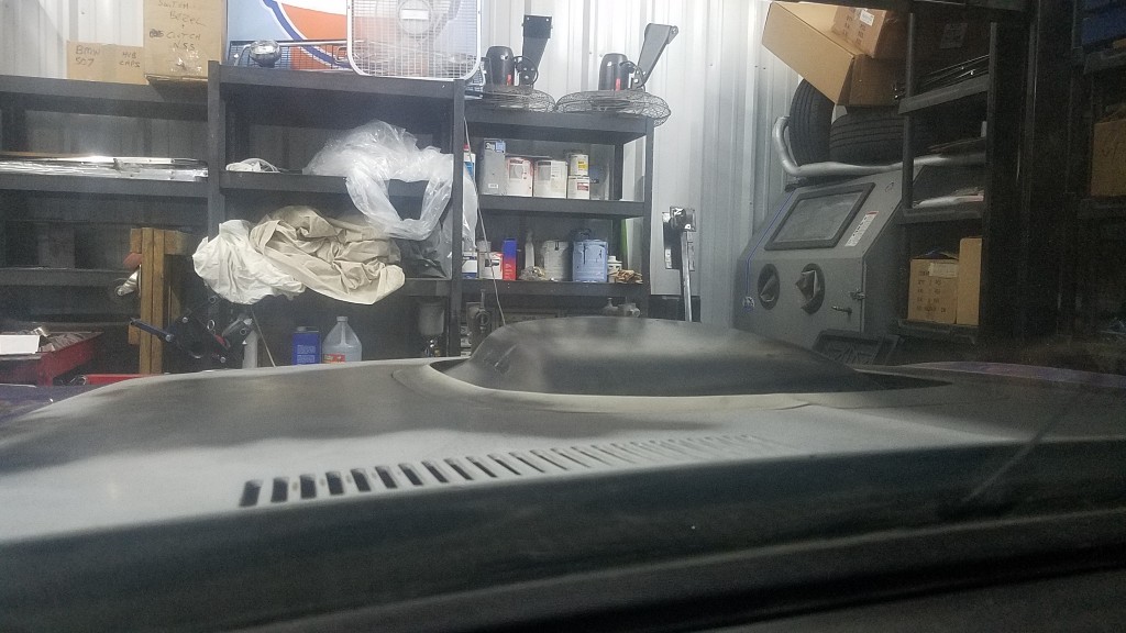

PS: Yes... bubble shouldn't be black!

Dave - Contrary to the current urban myths - Shaker bubble could be black or argent in 1970. Lot's of examples of both on good, original cars

The first is regarding the shaker scoop (bubble) paint. Going waaaaaaay back to Dave’s comment (Post #42, on p. 5), which is encapsulated in Jim’s above comment (#65 on p. 7): Yes! The shaker scoop could be painted either Textured Argent -or- Black Organisol, however, there was one exception. Because the hemicuda feature car in the advertisements was painted FE5 Rally Red, all ‘Cudas with shaker hoods, which were ordered in that color, in 1970, were REQUIRED to have a matching red shaker. In fact, many customers said that they ordered the car BECAUSE of the red shaker! The problem which incurred the ire of those who were in the body & paint department on the assembly lines, was the semi-herculean effort it took to make them look good! The shaker scoops had a rough finish from the factory, with imperfections which were covered by the texture of either the argent, or, black. In order to achieve an acceptable finish which matched that of the sheetmetal, it required quite a bit of sanding, and, filling, otherwise the smooth, glossy red finish would only amplify the imperfections! In an assembly line scenario, where time is money, all that extra massaging was not welcomed!
