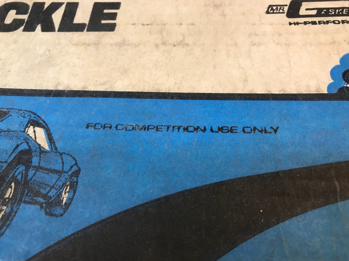

Bentley,
Let me know if these will work for you…
Sam...

More info.....
Sam...

Dang!!!! Id like those just to display. Of course those would fit what I need. Ill take em !! We will settle up. This site ROCKS!
