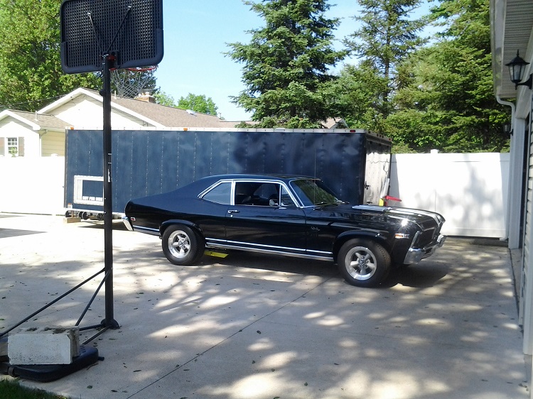

I had the vintage Keystone modified to a 15x8 and am running the M&H on my sister's 69 Nova. It is tight but if you want to make them work, you can.
To stay off the shock, there are options with relocating the lower shock mount, via a traction bar or simply using a shock that doesn't have a tin dust shield.
I post a pic in a bit
Paul III
Old 09-22-2018, 01:24 AM
PxTx's Avatar
PxTx PxTx is offline
Join Date: May 2001
Location: Glenside, PA 19038
Posts: 2,632
Thanks: 30
Thanked 59 Times in 43 Posts
Paul III
