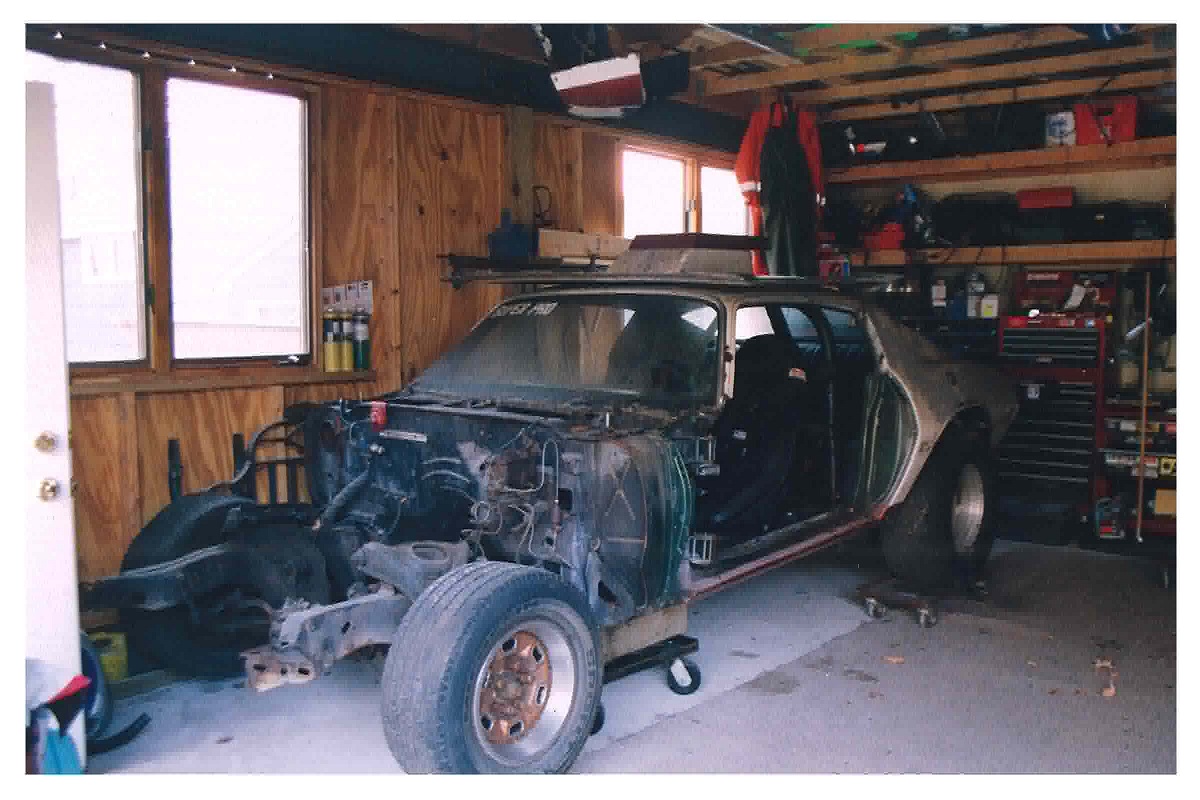

Thanks for the compliments Mark. I bought the car in 2004 where it had been a dedicated race car since 1973...not much left when I got it, but the shell sheet metal was really solid...but the front end/decklid were fiberglass and the doors had been cored-out. the LT1 was long gone as was the original Muncie, but the original COO rear is still there.
https://www.yenko.net/forum/attachmen...1&d=1505234984
Soooo....how are you progressing on your L-78?

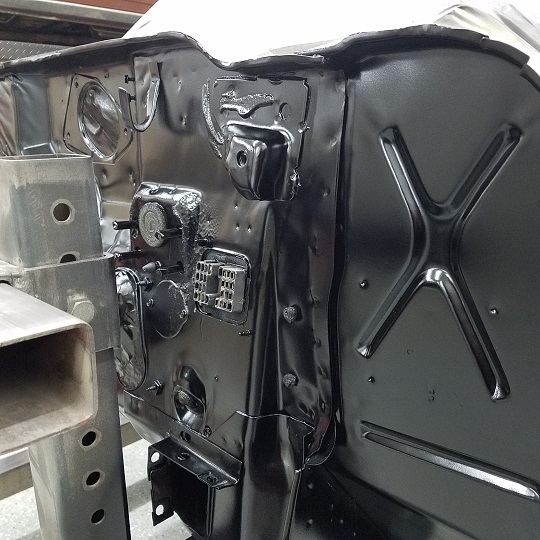

Wanting to show people who turn up their nose at SPI (Southern Polyurethane Inc)
Epoxy primer what was applied to bottom of my current 2nd gen Camaro project....
Firewall Pic show semi gloss PPG Delfleet Essential Polyurethane Single Stage
mixed to semi gloss....

Chuck, that looks great! I am hoping to be at that point soon.

Chuck that looks great, It looks like you thinned the SPI Epoxy and sprayed it on nice and smooth. Is that the final undercarriage color for a LA built car, or will it be coated the Norwood red oxide?
