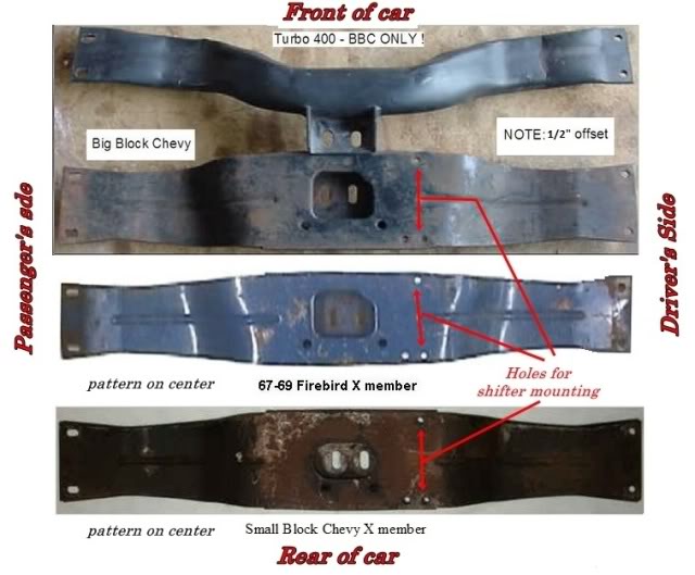

hey guys recently got my other 68 nova ss 396 going.. problem I am having is the driveshaft front yoke area probably has only a quarter inch clearance at tunnel area. the 68 frame was beat up a little bit so I have a 69 nova front clip underneath now.i have installed 68 big block frame mounts and motor mounts..will I need to install 69 frame mounts and motor mounts ..to get proper clearance at driveshaft area..? will that make up the difference to get an inch so clearance at driveshaft ?or , do they make a tranny mount shorter that the standard 1 3/4 tranny mount.. any help appreciated. Chris Teed.

The tranny mount is the same for all years. The sub frame and motor mounts are different for 68 BB novas. I'm willing to bet if you have an aftermarket cross member I bet the offset is wrong where the trans mount sits. Take a straight edge and lay it across the offset and compare it to an original cross member. I have one I think laying around if you don't have one. I think the only difference in a small block and big block cross member is where the trans mount bolts through it offset differently. The opening isn't oval for a BBC cross member on the bottom its shaped like Talladega speedway to accommodate the offset holes.

Jason, I believe that is the problem.. the repop crossmember is off centered somewhat.
