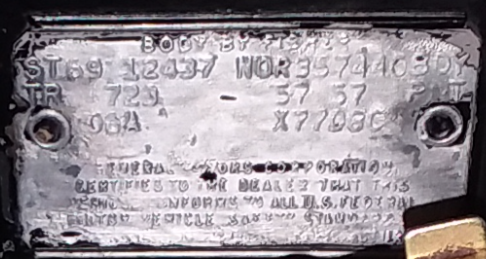

I would like to know if this trim tag appears authenticate.
The build date, trim code, and exterior color match with the car
Thanks

I am no expert at trim tags but it looks real

Tag looks legit but is badly corroded.
Car has been in the CRG db for some time. Had a 350 at the time, was a project.
Current motor ... either has a date correct block now or restamp?

No. Was recently painted at that time but still in pieces.

iam not a perfect expert but normally were the year is dated, the top of the 6 is very slightly higher than the 9!

Hard to tell from that pic, but that block may have been for sale a few years back. Has the same pitting by the Z.

The "Z" could have been re-stamped. Spacing doesn't look right.
