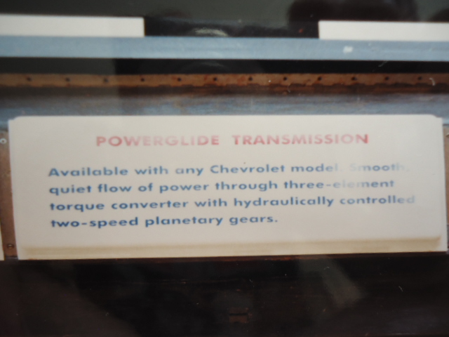

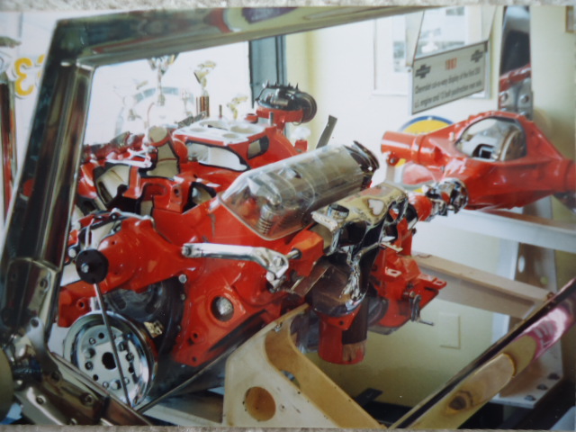

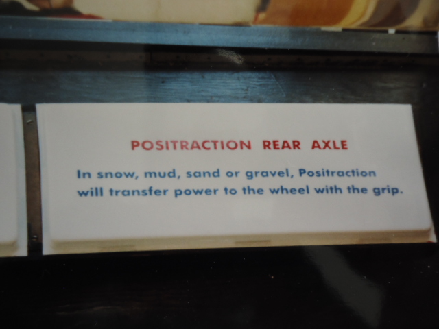

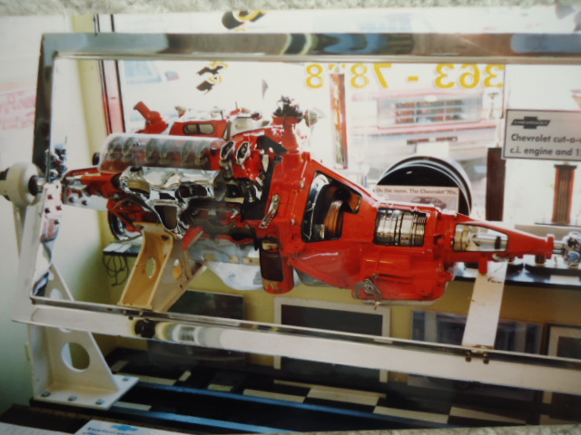

Pictures I took of a vintage original 1967 Autoshow cut away display of the new 350 cid. engine,trans & rearend @ Rons shop back some 20 years ago,right after he received it.

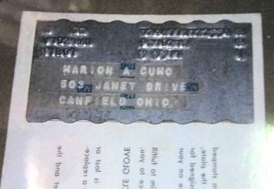

Subject VIN: 124677N122554
Drivetrain:
V1021MU
T7R07
PC1021G
Original owner:
Marion A Cumo
503 Janet Drive
Canfield, OH
