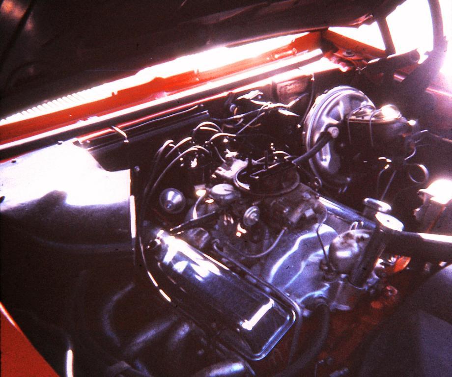

Photo taken summer of 68.

That picture looks familiar
