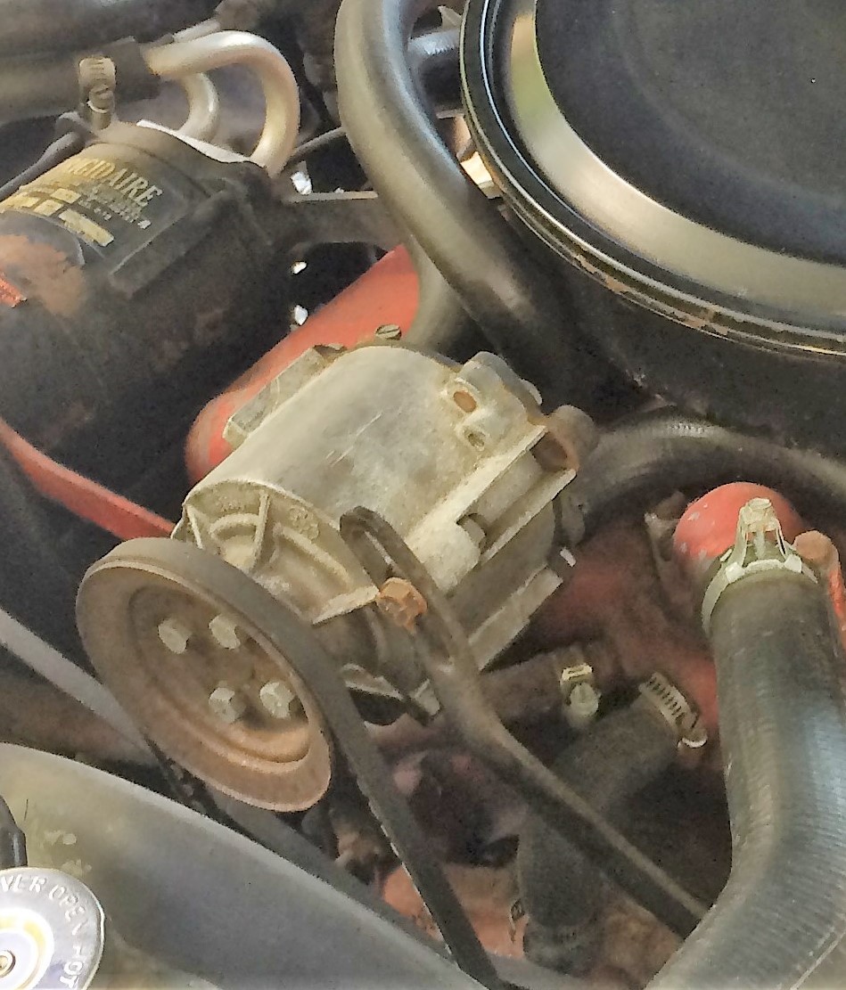

I may have access to a completer survivor 1967 BB smog set up off of a 396 Caprice. Would it be the same as corvette and any idea on value? I'm just trying to educate myself to help a deal work out.
Attachments - The Supercar Registry IMG_3900 (3).JPG IMG_3899 (4).JPG IMG_3899 (2).JPG

If I'm not mistaken, the passenger car application for the pump is different than Corvettes. I believe this has something to do with the inlets on the back side? I cannot recall decisively but I think a passenger car application has more inlets than a Corvette application?

----That looks just like the smog set-up on my 67 El Camino, which is also an air-conditioned big-block........Bill S

Yes it would likely be the same as what would be on a '67 Chevelle L35, some differences from L34 Chevelle or Corvette though. The complete system does have value!

What are the details on the car? Curious why such a nice looking untouched engine, and perhaps car would have this stuff removed from it.
