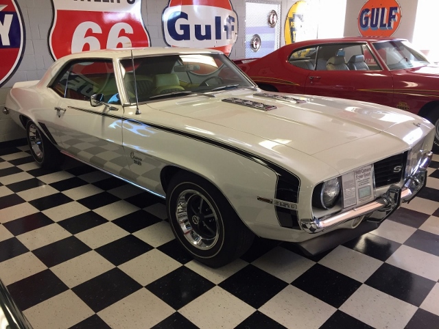

Default 1969 Camaro SS ... Real deal?
In the photo below - is this a valid Cowl Tag?

I say it's good.

Real Tag

When it was first posted with the smaller pic thought it did not look quite right.

Your thoughts now ?

Looks good to me. I know of another 50/B with 714 interior made a week earlier than this one.
