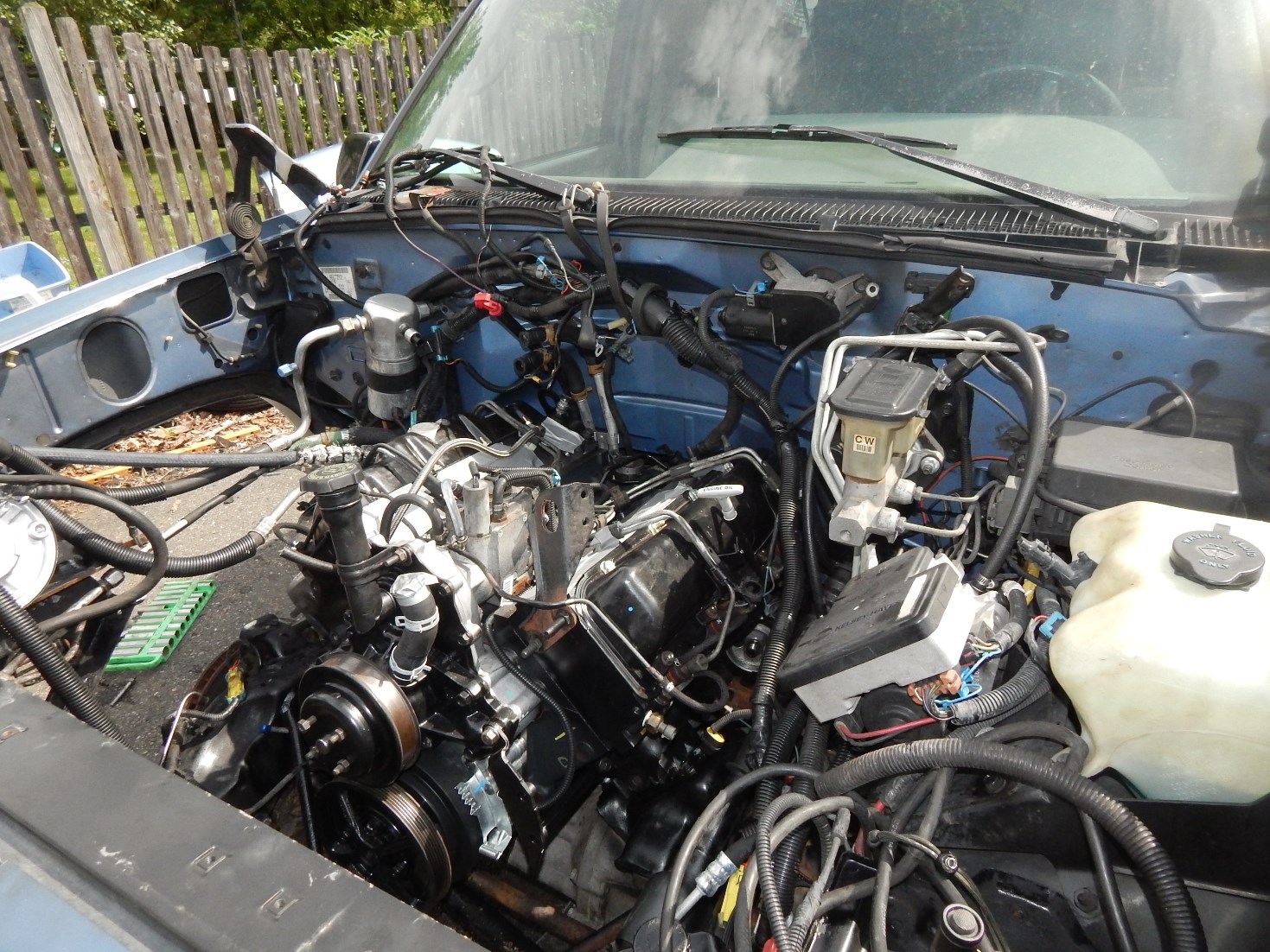

We have touchdown at 10:00 AM EST! And the wonderful wife gets credit for the assist as she helped hold the engine in place as it kept trying to twist out of flightpath as it touched down. The motor mount bolts just slid into place, too.

Got everything in, on, and back together working form 7:00 AM to 7:00 PM today. I left the inner fender off for leak checks, etc. The battery cables are still hanging (actually, the ends are soaking in baking soda and water to remove the trace of "battery crust" I found on them). I will try to start her up tomorrow. I have the laptop ready with the Scantech program for setting the injection pump.

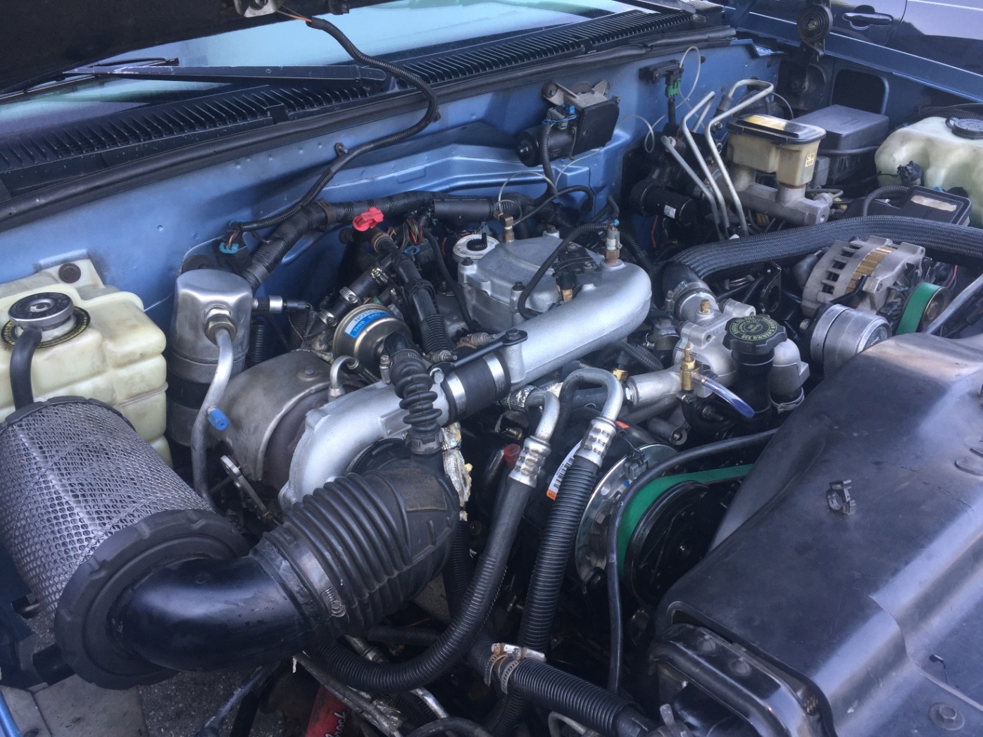

congrats Steve. That was a big job. I hope that new engine gives many years of service. You are right, its hard to find anyone that can properly work on those trucks and equally hard to find anyone willing to work on them. I am curious why you have the aftermarket air filter though Steve. Have you seen the temps of the air you are drawing into the turbo with that setup? The air temp under acceleration will go above 250 degrees. Put the stock unit back on and the temps immediately go back to outside air temp.

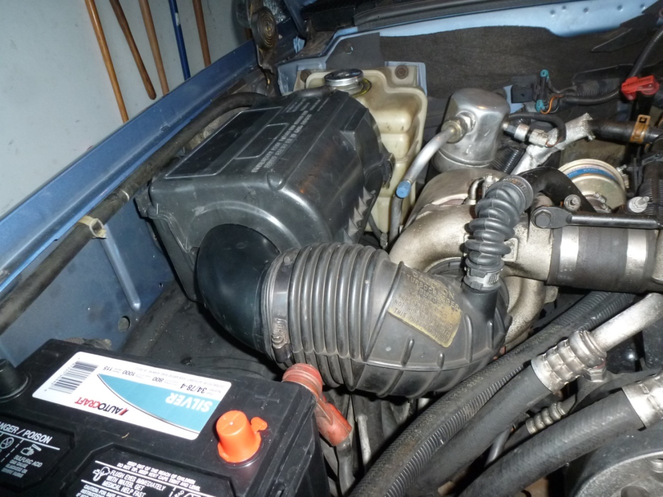

That's not what I run. That is just the air filter itself stuck on there to keep the critters out of the turbo as the truck sat overnight.
The entire filter fits inside the later model K47 air filter box which routes air from inside the fender. Here is the actual setup in place. I modified a piece of ABS toilet plumbing pipe from Home Depot. It cost all of $3 to replace the unobtainable and uber-fragile, thin-walled ABS duct piece that is unique to the 6.5 diesels used from 96 to 99. All I had to do was heat it with a propane torch and squeeze it in a vise until it became an oval shape that matched to rubber bellows that connects to the turbo. The round end of the tube fit tightly inside the K47 filter element that you saw in my previous photos.
