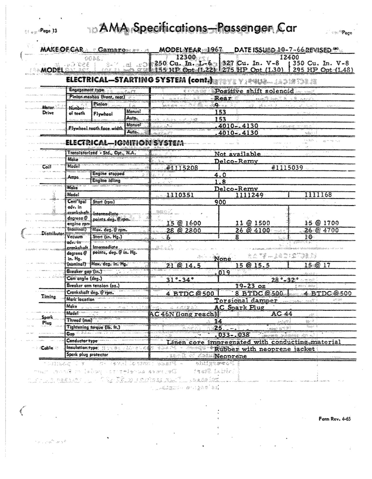

I'm having some trouble determining what is the correct coil for my 11B NOR 1967 Convertible. The car was assembled on Nov 11, 1966, and has a Tonawanda L30 327/275 with an 039 stamped (1115039) coil. I've owned this car since 1978 and the coil and correct bracket look completely original. Car seems to run fine with this coil.
I can not find any data on the 039 coil in the usual places such as parts books, Delco literature and internet searches. Does any one know what is the correct coil for this car and engine or have any information on an 039 coil?

Default Re: 1967 Camaro Ignition Coils
Thanks very much for the tip. I had thought about the AMA data and I believe I have a copy of the file somewhere as I'm pretty sure I downloaded it sometime in the past. I was going to check it but never got around to it. The AMA data was issued on 10-7-66 which is the same date as the harness number was changed in the AIM. Possibly a coincidence. Looks like the 039 coil on my car is original equipment and meets the date criteria. I'll measure the resistance of the ignition to coil wire tomorrow. Today I measured another 1967 Camaro harness I have and it measured 1.8 ohms exactly as per the early specifications. I also measured a 1968 Nova and a 1967 Firebird 400 that I have and both were 1.5 ohms. Not sure what the spec is for Firebird but the 1968 Nova spec is 1.35 ohms.

I went and checked out the Camaro today to measure the ignition to coil wire for resistance but it was really too difficult to do quickly now that it is pretty much finally assembled with all the sheet metal and wiring in place. I'll have to do it another time. I now know that the wiring harness and the coil were all born together so I'm not worried about an incompatibility problems.
For those who are interested I've attached the AMA spec.
