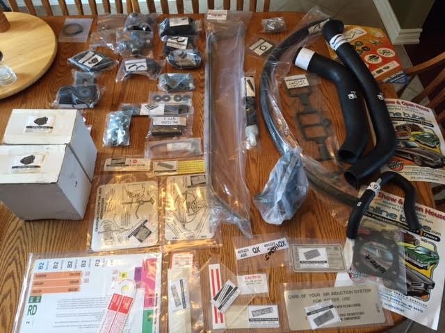

Double W-31 Delight today!!!! Mail Man showed up with another load of Inline Tube parts:-)
Lots of little items:-)
Engine and trans mounts, hoses, u-joints, stickers, emblems, core supports, rad saddle mounts and shims, gas tank straps, exhast manifold gaskets, thermosat, and gasket, rear axle to backing plate gaskets, wheel well moulding screws, rear sway bar shims, bolts, nuts, washers, gas tank vent, clutch boot, etc, etc!!
The stickers are a little premature but while I was having items shipped (might as well)

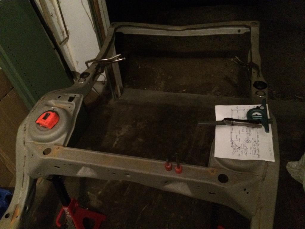

I got the small repair rings laid out on the bare frame:-)
Measured a few hundred times, used an original frame dimensioned drawing.
All the diagonal measurements look good plus or minus an eighth of an inch.
Plan to try to get these welded Thursday after work........ so I can get the frame back to the media blaster.
I should have shiny parts next week, on my revised schedule I need to be done the frame this month:-)

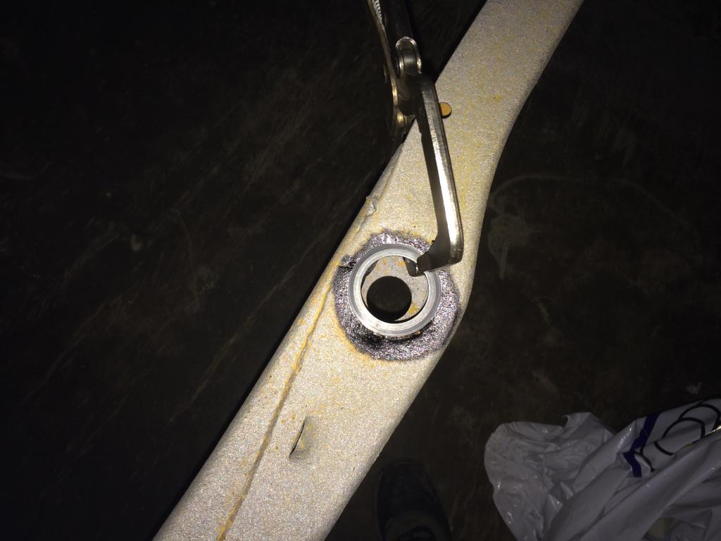

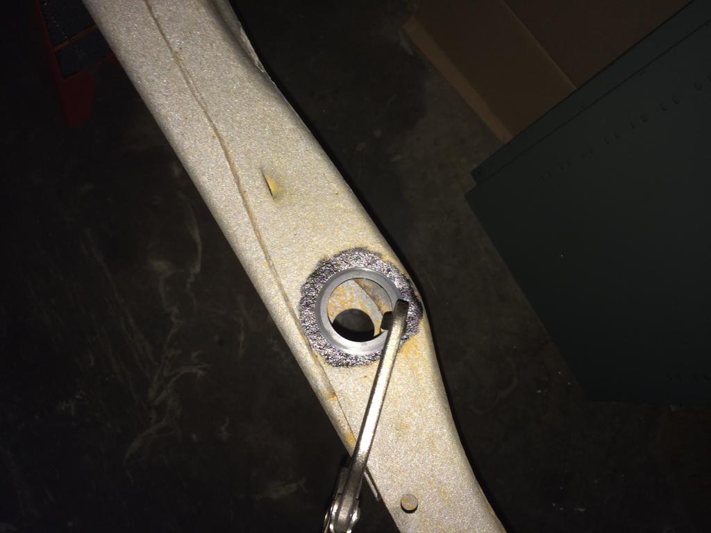

A few pictures from preparing last night to repair the two body mount holes second from the back of the frame on both sides.
