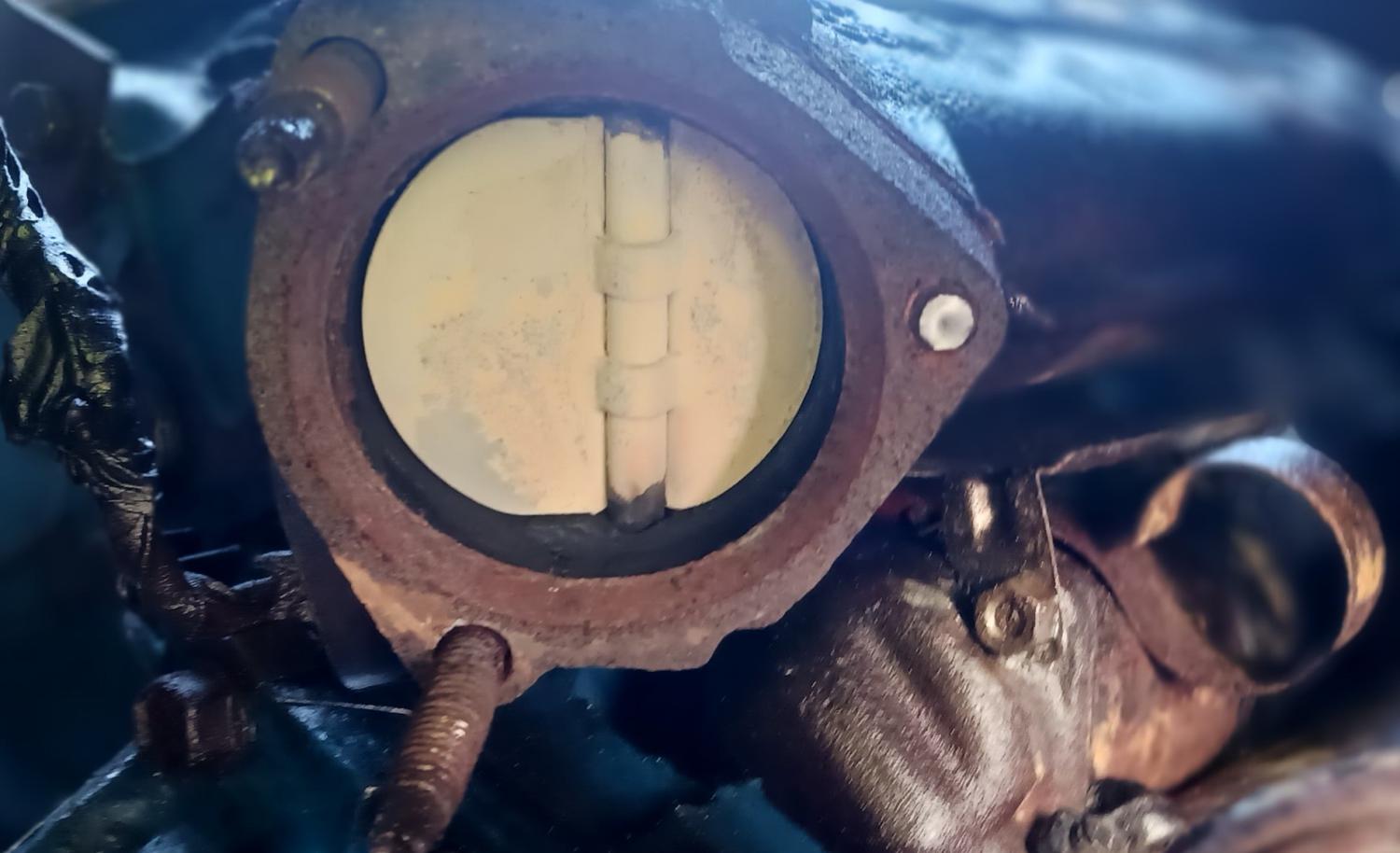

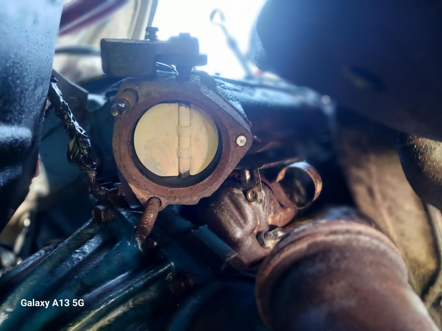

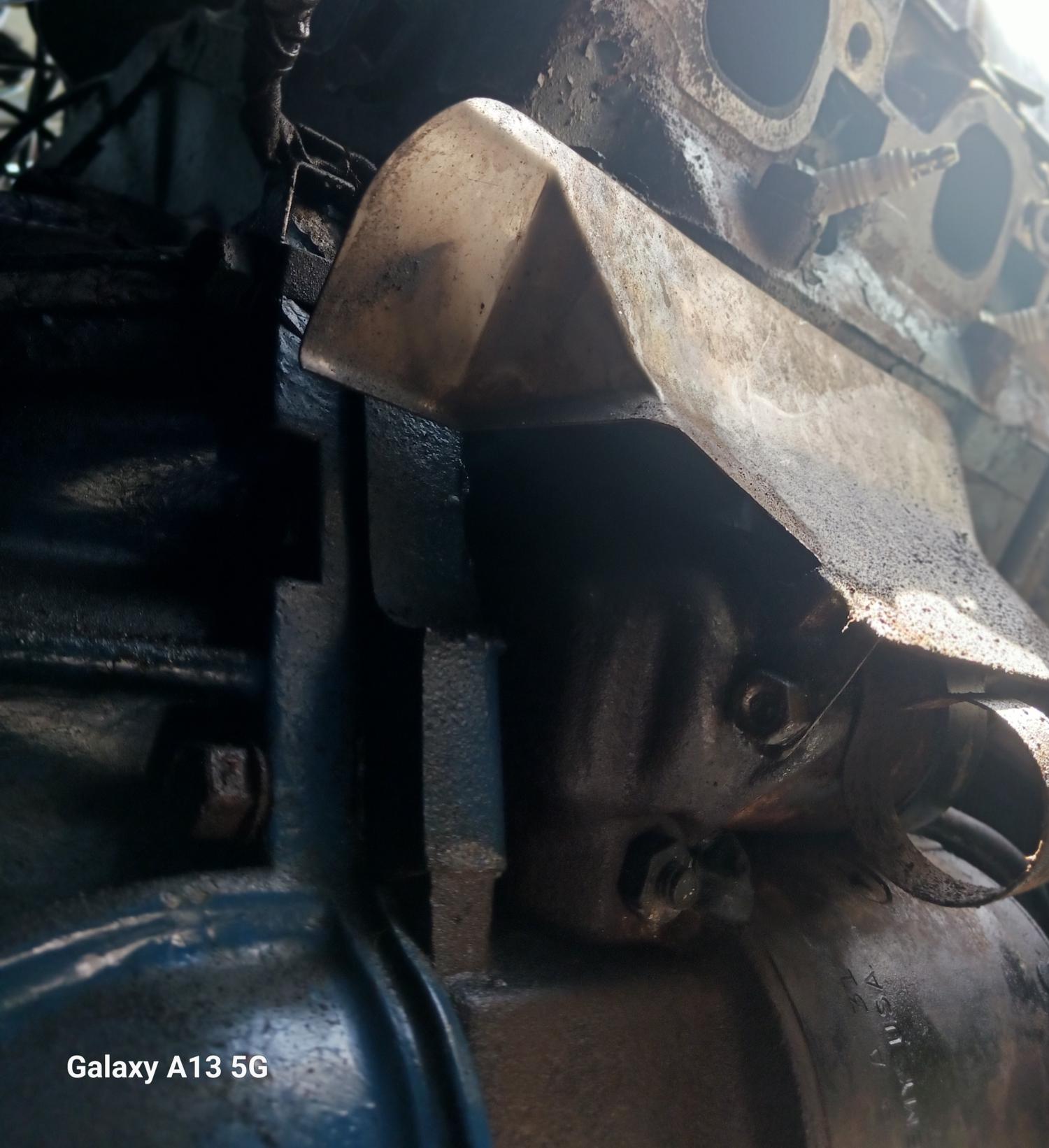

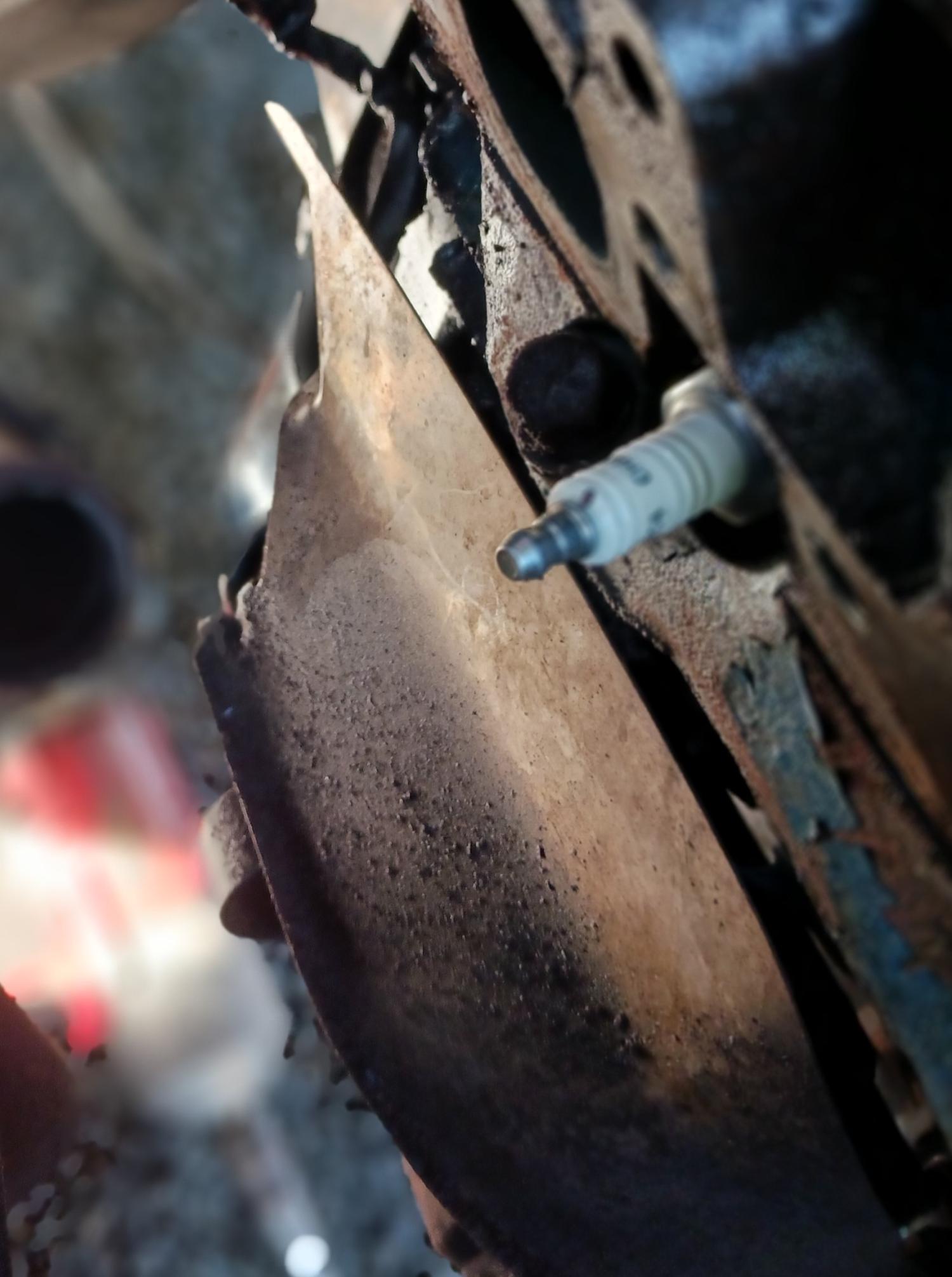

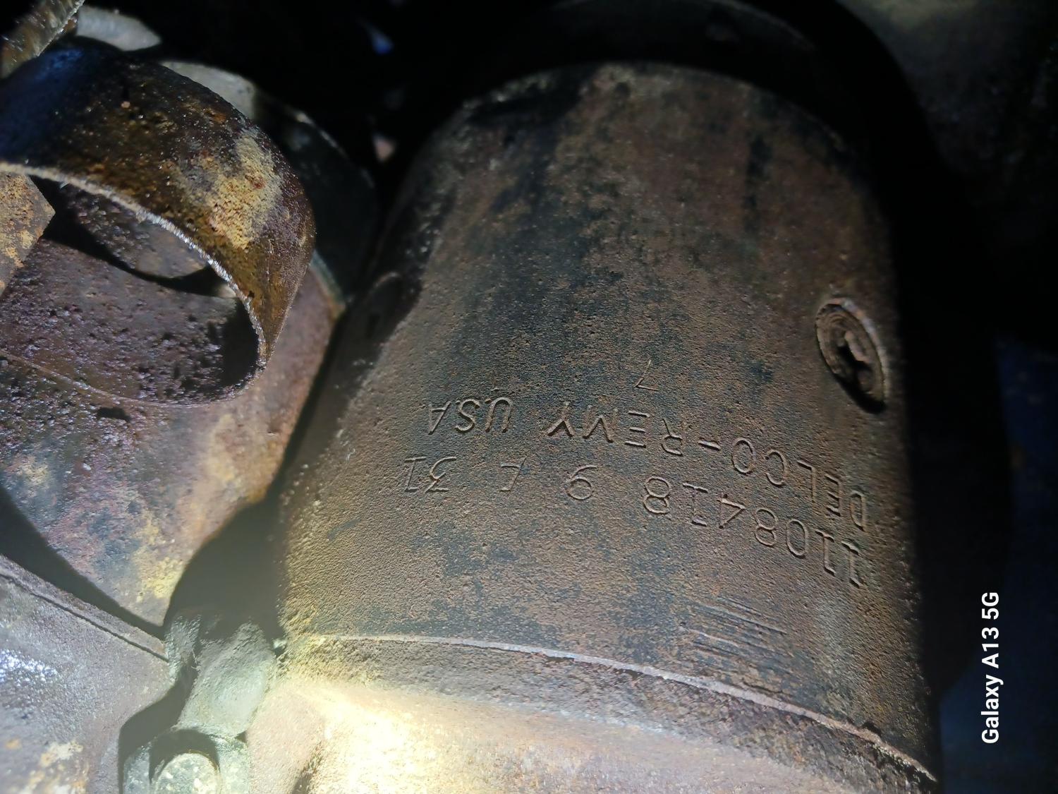

Factory one.
All I have of starter- heat shield.
Slotted tube nut holding heat shield to solenoid bolt is not back on in pics.
It appears to be phosphate like wiring clips on bell and solenoid.
