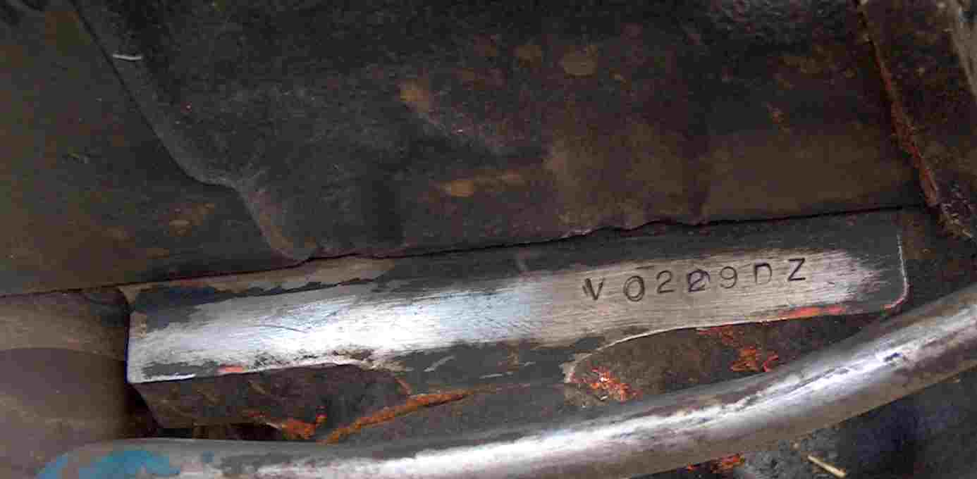

I'd like to hear opinions on this 837 alternator's stamping.

It compares favorably with the examples I have.

I say no good. Look carefully at the 37 in the 837.

Not sure about that one ?. Not sure 9C12 is a known good date [img]<<GRAEMLIN_URL>>/dunno.gif[/img] Here are some 9C7 and 9C24

The entire 1100837 37A stamp matches what I have.
If you were going to re-stamp one would you pick a date that 'wasn't known'?

<div class="ubbcode-block"><div class="ubbcode-header">Originally Posted By: William</div><div class="ubbcode-body">The entire 1100837 37A stamp matches what I have.
If you were going to re-stamp one would you pick a date that 'wasn't known'? </div></div>
William can you post your stamp example. I've seen other anomaly's but when I see two or more alike I either accept it as real or suspect its the same re-stampers work.

I'm pretty sure I see the remnants of a 4.
Yes, it's done frequently, I have pic's of some.

<div class="ubbcode-block"><div class="ubbcode-header">Originally Posted By: L78steve</div><div class="ubbcode-body">I'm pretty sure I see the remnants of a 4. </div></div>im with you Steve. If you blow up the pic, you can see remnants of a 4.

Thanks guys for your opinions.
I think I see what you're saying about the &quot;4&quot; remnants.
