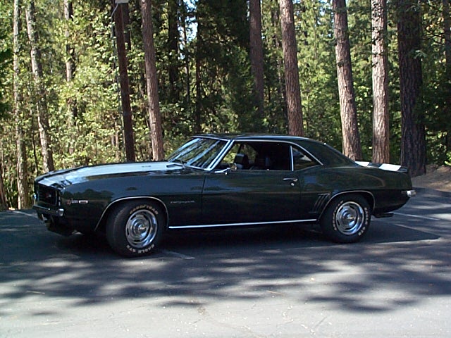

After much work and effort I have been told by my mechanic that my '69 Z needs a complete engine rebuild. There is too much exhaust smoke, oil getting into the intake runners, and the engine cannot hold vacuum at idle, it dies. Distributor has been gone thru, new valve seals, carb work, and intake manifold resealed. No external vacuum leaks can be found. Car has 80,000 miles on original engine that nothing has ever been done to, as far as I know. I can't afford a complete engine rebuild so have decided to sell it. I've owned it for 19 years and maybe it is time to pass it on to someone else to enjoy. I know what I would ask if the engine was fine but have no idea about the value knowing the engine needs to be rebuilt.
Here are some details on the car:
Original engine and rear end, trans is not original.
All sheet metal is original as far as I know.
Car was repainted in original Fathom Green more than 20 years ago. Paint is still excellent.
I have original Protect-o-Plate and Chassis Broadcast copy and owner's manual, along with pictures of the car when it was only 2 months old from the original owner.
Original black and gold California license plates. Period correct, although not original to car, dealership license plate frames.
First aid kit from dealership.
Five correct date coded YH wheels and 5 reproduction E-70-15 Goodyear Wide Tread GT tires.
Interior is in great shape.
Everything works except clock, fan blower motor, low fuel indicator light, and headlight washers (it is a Rally Sport also).
I also have that would be included with the car:
new OEM style restoration radiator and mounting hardware, new Holley 4053 DZ carb, and new OER fan shroud and mounting hardware.
How much might my car be worth? I know it is hard to come up with a value without seeing the actual car, but I would appreciate any help you guys could give me. I am going to try to add some pics with this post if I can decipher how. Thanks again guys.

Huh??? AFAIK, the only way oil can get into the intake runners is if there's a blown intake gasket or a cracked intake manifold. That could also cause a lack of vacuum and engine dying. I think I'd be seeking another opinion from a different mechanic.....don't give up on the old Z just yet. Beautiful car!

Beautiful car. I know you've heard this already but you would really do yourself a disservice by selling such a nice car needing an engine rebuild. The typical high dollar collector won't want to deal with the engine rebuild so you're limiting your market pretty significantly. I'll say the car is worth $15k less on the open market needing the engine rebuild.

The problem you describe is exactly what just occurred with a friend of mine's 1970 Challenger R/T 440. It turned out that there was a crack in the intake manifold on the valley side that was invisible to anyone outside the engine. When the car warmed up, it ran like crap. After swapping carbs multiple times, he finally pulled the engine and that's when they discovered the crack on the underside of the intake. It caused a major internal vacuum leak that sucked the oil from inside the lifter valley into the lower runners of the intake.
Before letting go of the car I'd swap intakes out and see if that fixes it.
