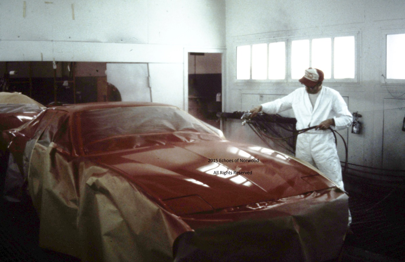

Q. How was the car finished?
A. Car was sent to AGR where the trim was removed from the front end to the fullest extent practicable, and then the paint Fisher left in the trunk was used to match the front end in. This was again a problem as we had to match Fisher's Primer to get the top coat to match and often they forgot to give us the primer. Remember we were two separate divisions then. Next was the oven where we did the best we could to get reflow and a gloss match but there was only so much we could do. These paint jobs were often terrible with high customer dissatisfaction.
Q. What about overspray in areas under the hood- at AGR?
A. Sure. Think Earl Sheib quality. The hood was popped to get the edges..so yes they taped it off the best they could but these were done very fast.
Q. Did the AGR Process change much through the years?
A. A bit when we switched to Towveyor, but we still painted cars in AGR one after the other right up to close of the plant.
Conclusion:
<span style="text-decoration: underline">The Picture Below is AGR in 1982. In this case I believe William and Jerry saw a bad quality paint job. I believe Clem and his wife were the recipients of a bad quality paint job that was likely a bit on the light side. I believe all parties have acted in good faith and the recollections of these two workers place this situation in proper prospective. The car in question was EO just a light EQ and poorly mixed, poorly matched, and perhaps on the inconsistent side in coloration to boot. The wiper transmission overspray as reported by the restorer is consistent with an AGR front end paint job</span>

The wiper transmission was installed on cars by fisher was after the body was painted, however in the case of SPL Paint the front ends were installed as fully assembled primed units then in repair booth they were stripped of trim to a practical point taped and painted reassembled and finished.
Normally we say as an absolute that over spray on a wiper transmission would not have happened at the factory as this goes to show you, the only absolute is there are no absolutes.
