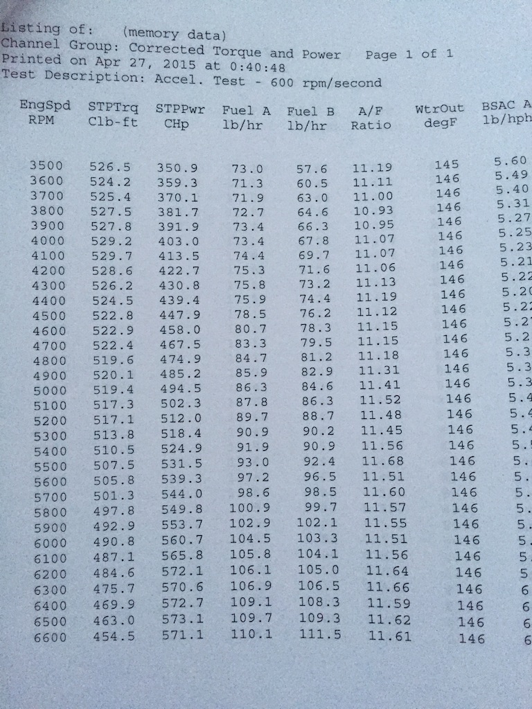

I'd like to see the torque numbers on both engines.

Here you go, not the best pull but a good average one. Engine 1.

Something tells me that engine 2 will have quite a bit more area under the curve... [img]<<GRAEMLIN_URL>>/smile.gif[/img]
