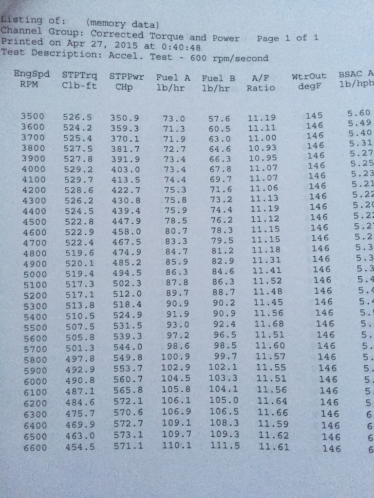

Engine 1.
Blue printed .060 over L72 427, 12.2 compression, 242/242 520/520 solid lifter cam, stamped LS-6 rocker arms, stock GM 840 rectangle port heads, 2.190/1.720 valves, factory 163 intake, 4 quart factory oil pan.
Engine 2.
.060 over 427 10.3 compression, 264/264 560/560 solid lifter cam, roller rockers, ported GM oval port 781 heads, 2.190/1.880 valves, Performer RPM air gap intake, 1 inch open spacer, Moroso oil pan.
Both engines will be tested with the same Holley carb, 2 inch headers with mufflers, which one will make more power?

Thanks for the replies. Engine number 1. has been tested and made 575 HP @ 6500 RPM, very impressive when you consider the factory cam specs, I could see the vacuum coming in at 16 inches at idle. I ran the the engine to 6600 and was down 1 HP, I really like the way the 427 carries the power out, this is very important to me. Engine number 2. will be tested this week, I will post the results. Its interesting todays 236 headed flattop piston Super Stock 454 makes right at 720 HP, with the 049 headed version making 740. Ken, I would be interested in where your S/S 454 peaked?

I was figuring on ~550 HP for engine #1 and 625+ for #2. Seeing engine #1 already made 575, I'll revise that to 50 HP. I still think #2 will make 625+. I know your 467" version makes 660+ HP and over 600 lb.ft. I'd think the 427 should be close to those HP figures with a little less torque.
