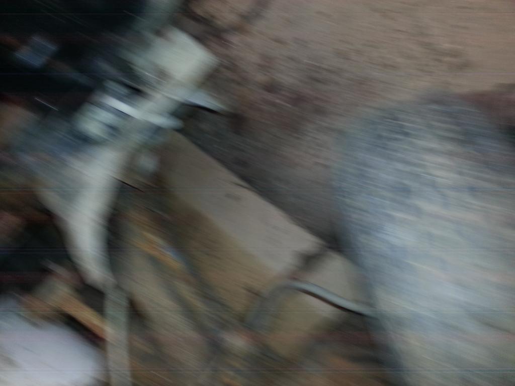

This is from my 69 granny car...it's not the best angle but if you blow it up and look close you can see the flap. I will try to find a better view.

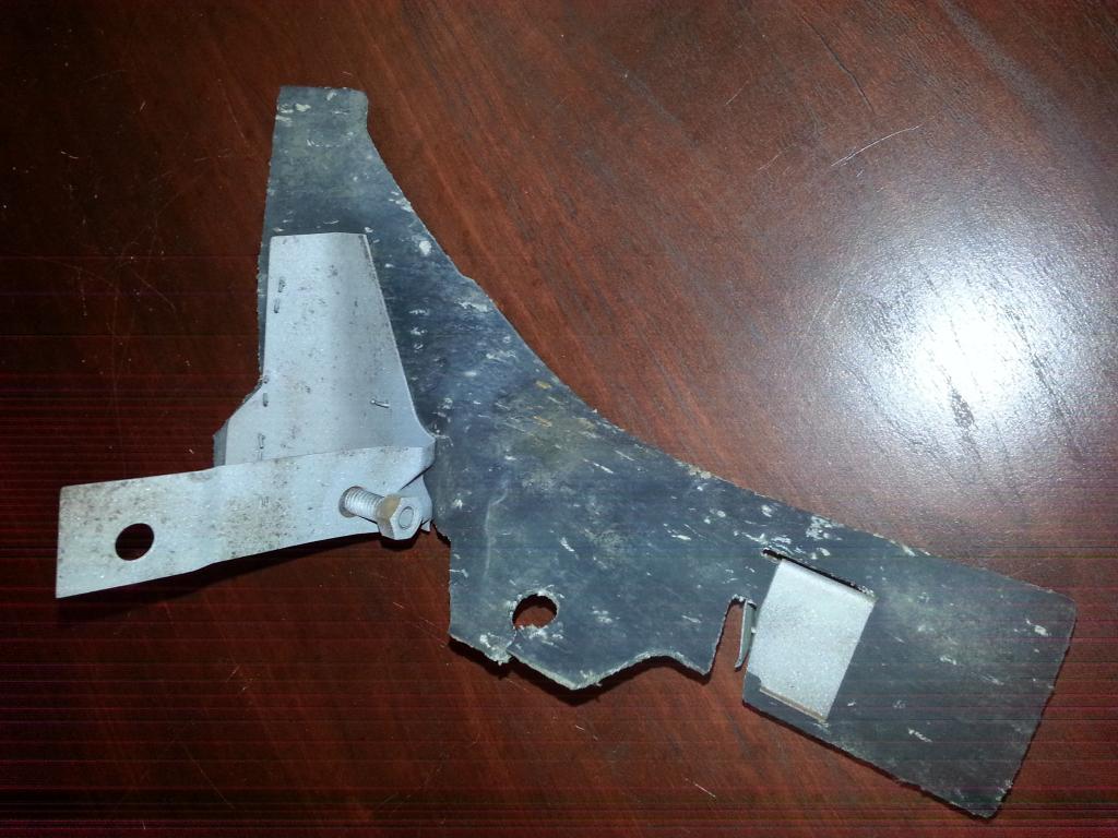

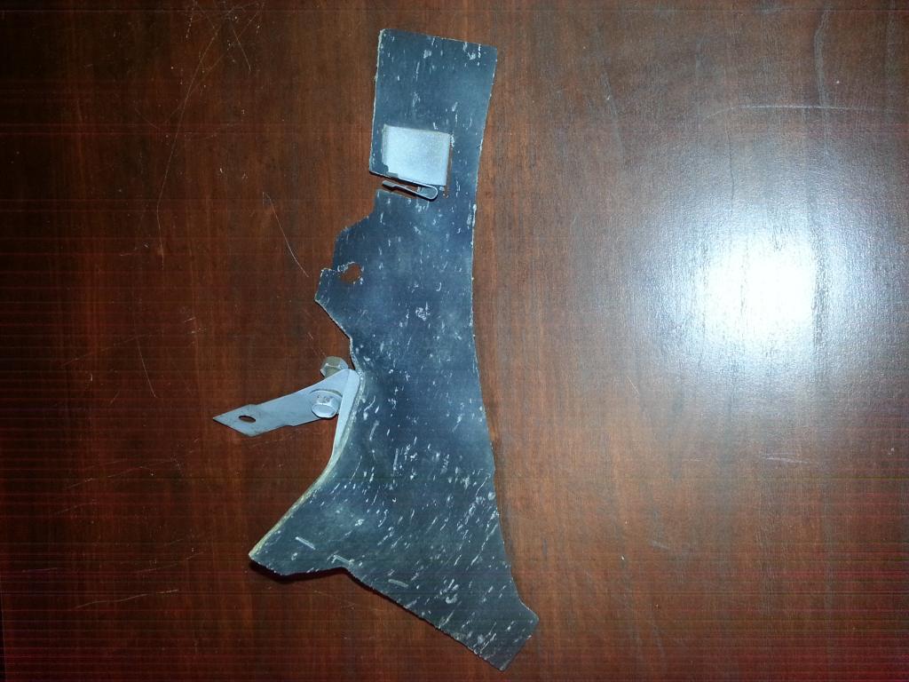

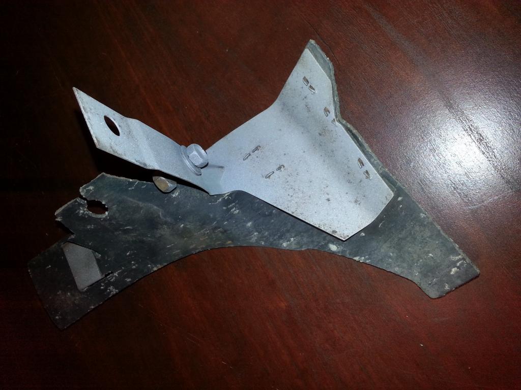

I think the photos I am posting are of the shield in question.

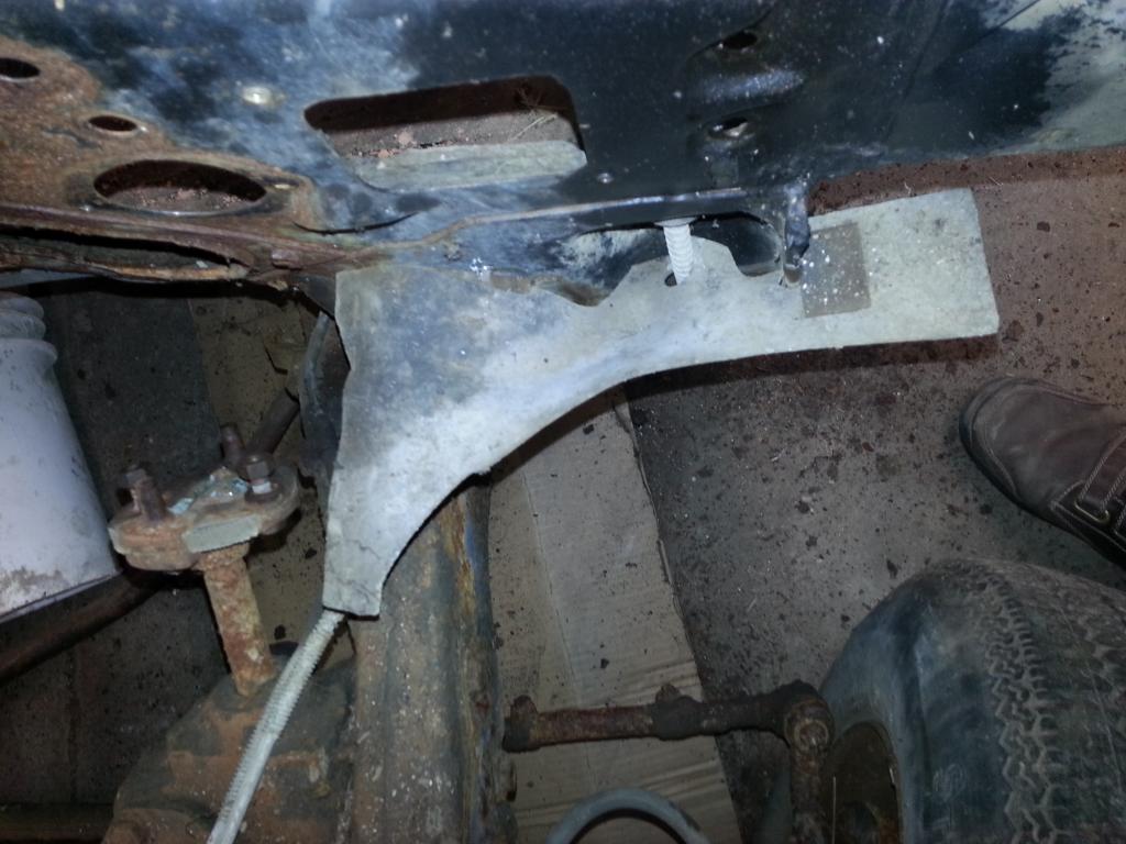

This is off of my 68 Nova parts car yesterday. A photo of it on the car and a few photos after I media blasted it. I have seen these before and never found one on the passenger side ever. Two 5/16 X 1 bolts on the firewall and a clip that slides over a protrusion on the firewall as well.

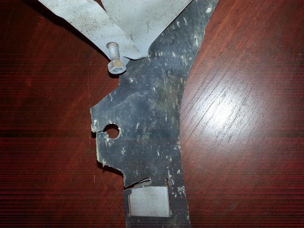

The large bracket was dipped in black paint and the clip was bare or possibly plated. See staples holding the rubber shield. The rubber is the usual thin rubber with the threads showing, I believe it is the same oem material used for the inner fender A arm shields.
