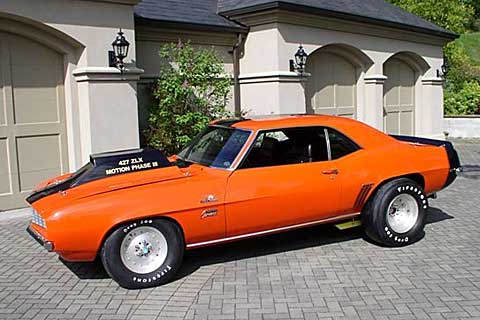

  #24
Old 12-18-2014, 11:00 PM
Posts: 10,348
Thanks: 3,210
Thanked 4,672 Times in 1,160 Posts
Default Re: ZLX question
Picture taken when Kevin S. owned it.
