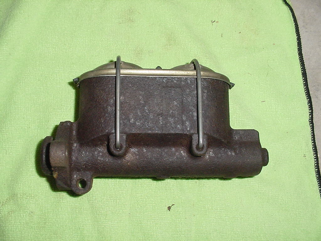

The last owner says this is the correct master cylinder the part # is L2229771. If this is not correct what is?

Your master cylinder should resemble this one.

Disregard the remote oil filer in the picture but this is what the J52 non-power assist master cylinder looks like. It mounts level rather than tilted as in the J50/J52 combo. It's shaped slightly different and has no bleeders.

Here is one for 67 Nova with manual factory Disc brakes. No bleeders is correct
Not sure if 67 Camaro are the same "AD" code as the 67 Nova is as the M/C casting number #5459467 for
4 piston calipers.

Looks similar to 67 Corvette w/o power brakes as well??? [img]<<GRAEMLIN_URL>>/dunno.gif[/img]

Do you know where I can get one is this one for sale?

Another MC pic and info is here: http://www.camaros.org/suspen.shtml#Brakecomp
