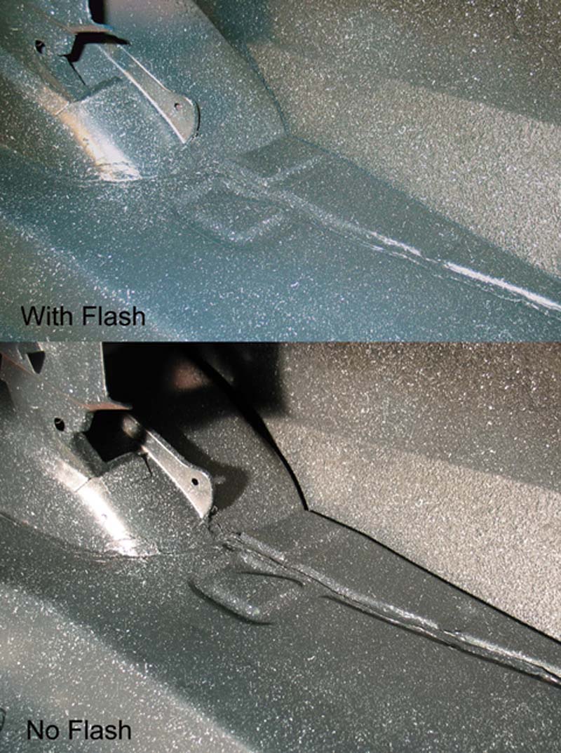

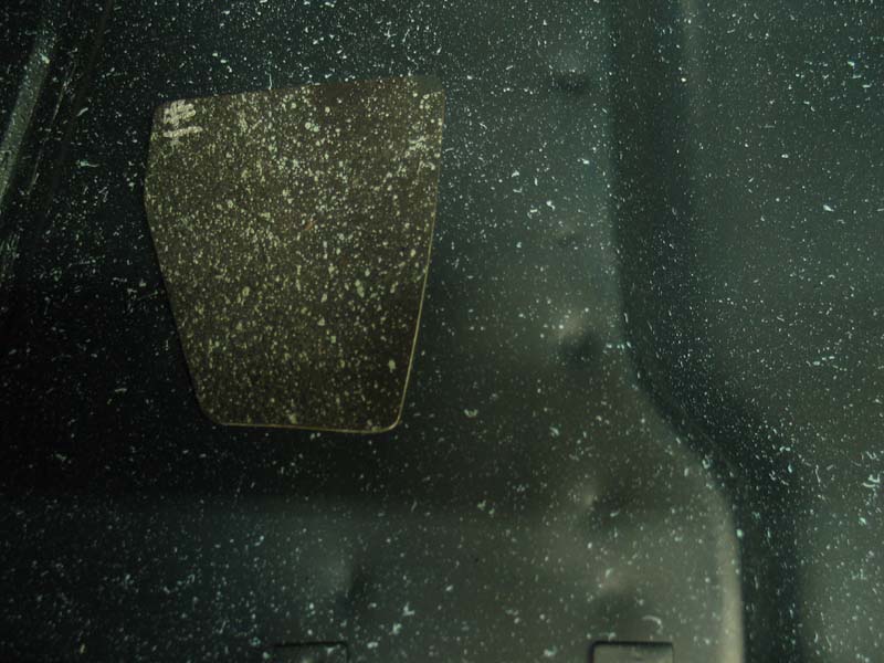

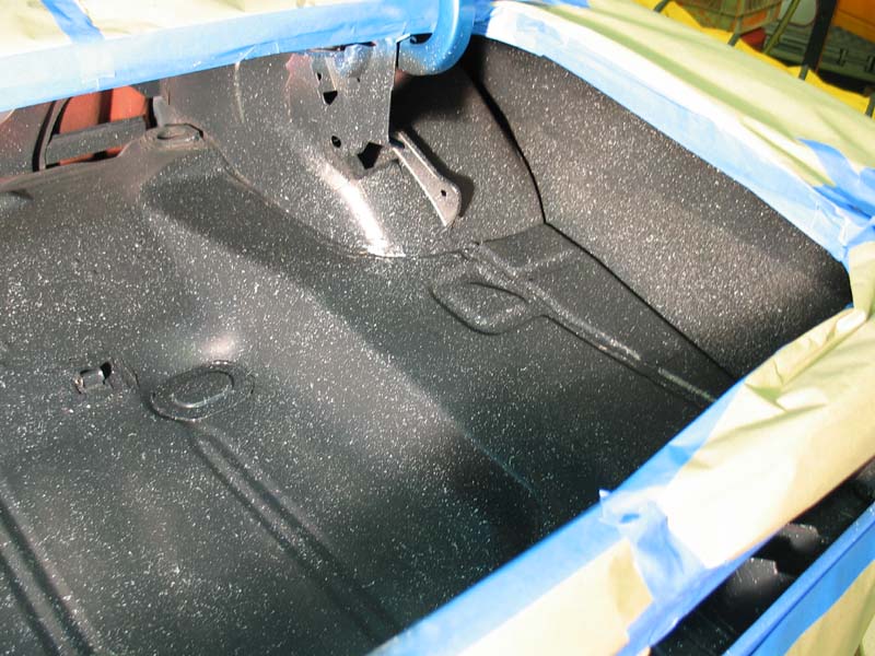

I got as close as as I could with what I have on hand and painted my trunk. It was very frustrating to take a picture of an original trunk and not have it match an actual sample. My flash changes the color appearance. Here is a couple pictures of the finished trunk. The background color I used is "RM Diamont TA 1106" its a flat interior paint. The splater I have to find out if I can get more of. It is really hard to work with and I could only spray it with a paint pot and external mix gun. I will report back on the splatter. George

Looks great George!
