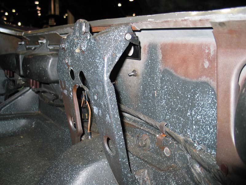

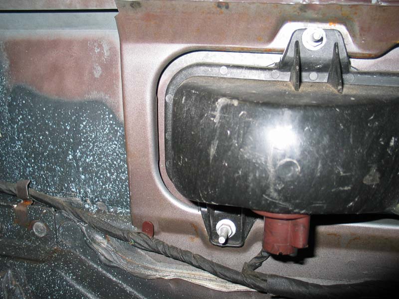

These pictures are of Terry R's car, also very nice original car 69 SS/RS LeMans blue 396 loaded. These pictures show more details on where trunk paint was applied or not. Also notice the wire harness metal tab was folded up after the paint was applied, bare underneath. George
