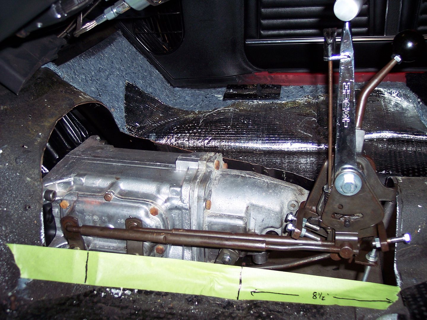

You can see the tunnel is cut 8 1/2 inches behind the second rib. You can also see the interference between the reverse linkage and the bottom of the seat. I am put spacers under the seat and reweld the reverse handle to face forward. I could also use seat extenders. As it stands now, the ergonomics are not bad between the shifter, steering wheel, pedals, etc.

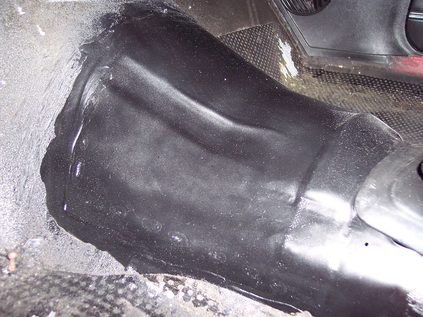

After some untalented attempts myself at the trans tunnel, I enlisted the help of a friend that owns a shop here in SE Wisconsin Topline Design and Speed. 2 days later, tunnel made, fitted around the Ram Rod, and tied into the driveshaft tunnel. He even fitted the tunnel to utilize the NOS Ram Rod boot and ring. As you can see, it's a little tight by the seat. All was TIG welded, seam sealed, and painted.
Full speed ahead now. After I get back from Wisconsin Dells this weekend, I'll get the clutch in, the M22W, order the driveshaft, and get back to the beatings.

nice job! glad the boot went to a good home [img]<<GRAEMLIN_URL>>/beers.gif[/img]

Looks great Tim!

Very Nice Job! Love seeing these pics. Thanks

Very nice work!

Tim...looks great and your making us 67 Nova owners proud of the nice work! [img]<<GRAEMLIN_URL>>/biggthumpup.gif[/img]
That NOS boot fits right in too! I have to get me one of those some day to go along with my Hurst Ram Rod. Keep the pics going.
