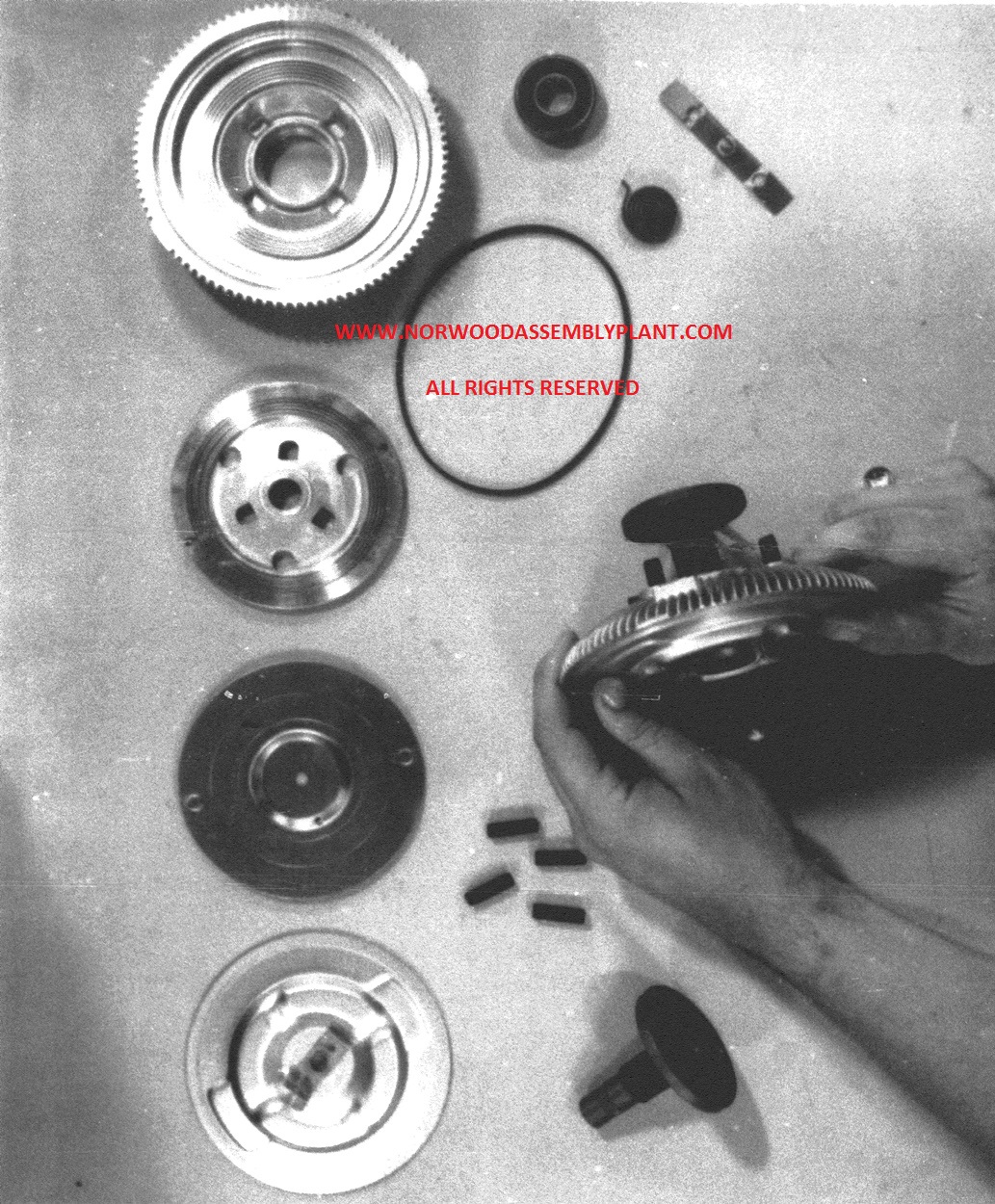

I have a Photo I came across while doing the research for the book showing a detailed clutch fan part illustration. I will post it here later today. [img]<<GRAEMLIN_URL>>/biggthumpup.gif[/img]

The parts that comprise the fan clutch assembly are: (clockwise starting at the right hand)
Studs, Shaft, Cover plate assembly, pump plate, clutch plate, gasket, body, bearing,
external bi-metal arm, and shaft assembly.
