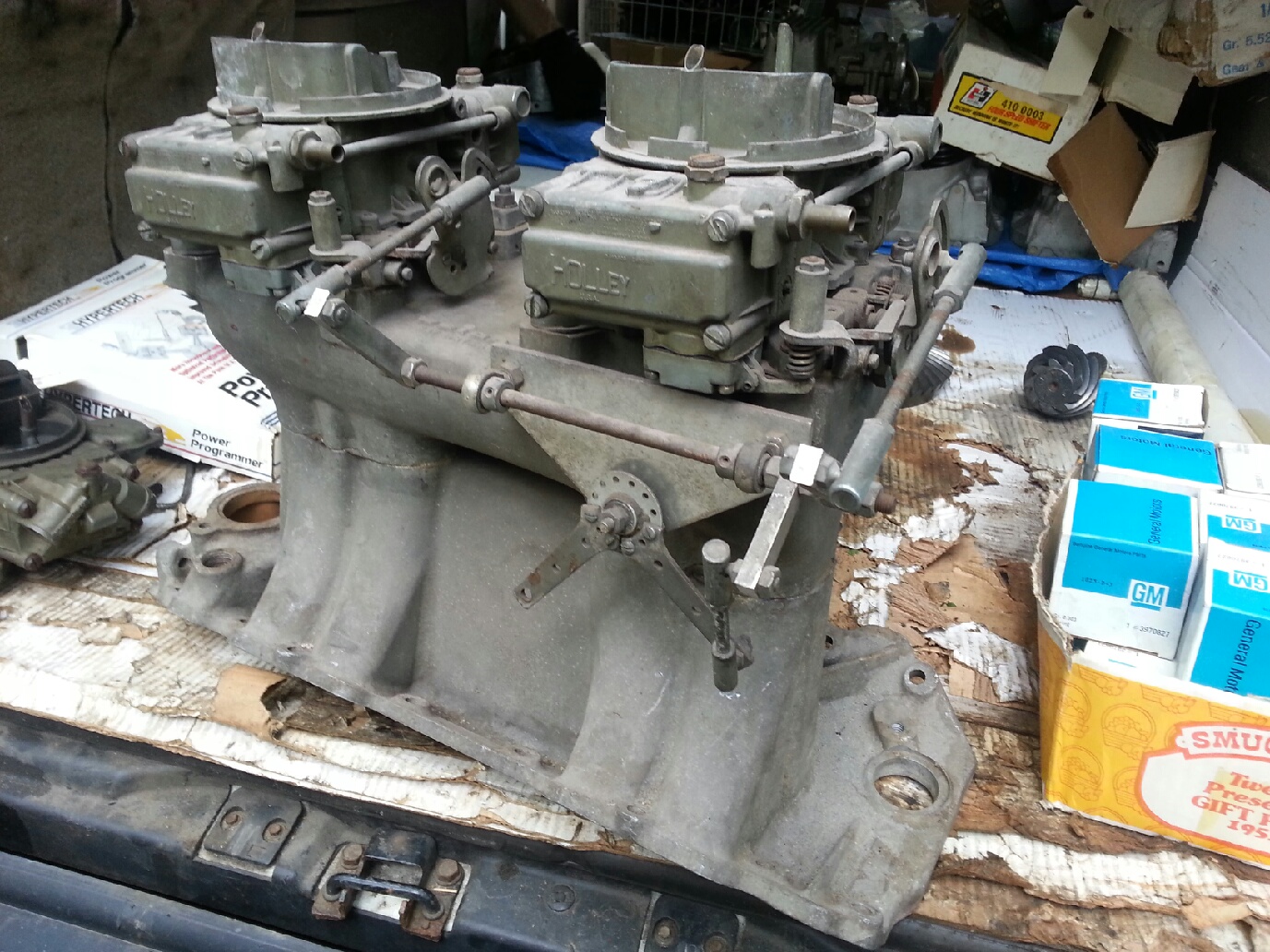

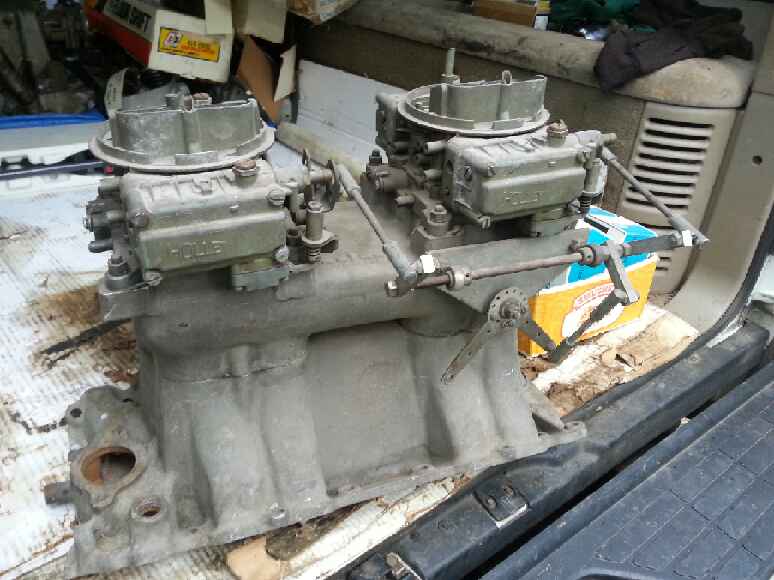

Here is the vintage setup I have. Put together in the mid 1970's for a race car. Has sat ever since I picked it up.
