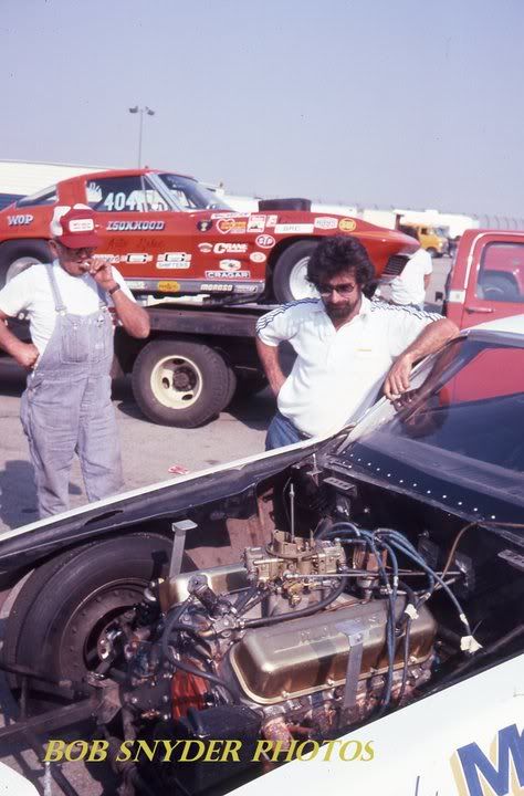

In contrast,here is the engine compartment of Grumpy's Toy#8 after Richie Zul had SRD rebuild it for him. This is Dennis Ferrara in this pic. This is what pretty much all SRD prostockers were built like in 1974,which is why I know this car was originally built early on.

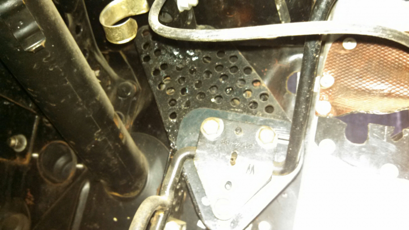

Apparently the gas,clutch and brake pedal brackets were all too heavy as well. And the inner cowl area must have weighed a lot since it was removed and the pedals and column mounted to the roll cage.

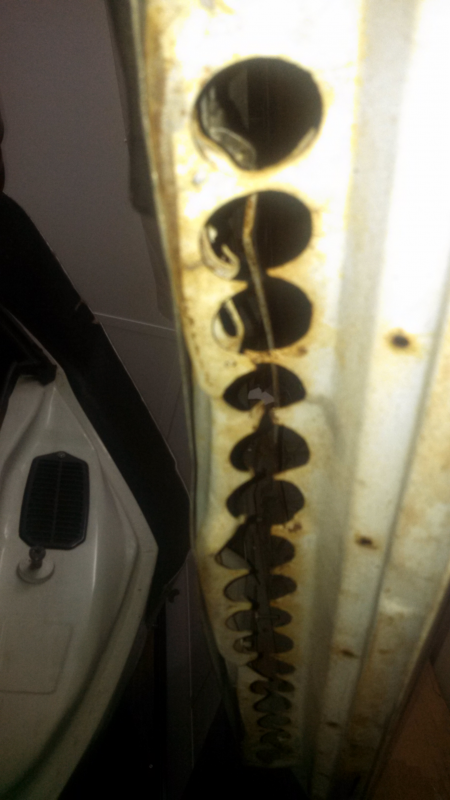

I guess even after acid dipping the doors were deemed too heavy and the hole saw came out. The holes now need a little fixing but the doors are useable.
