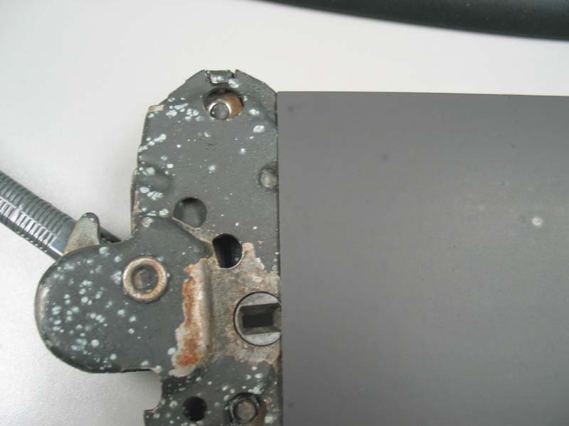

Lynn, I believe the trunk dividers were installed after the trunk was painted. I don't think they would be installing any trim untill after the painting was completed. Sorry to say; it appears you may trying to match to a resprayed trunk. I have looked at several original trunks and never saw paint on the divider. Here is a picture of my buddies 69Z 30K orig paint car. I also sprayed out the background paint I mentioned and it looks good. It will hold up better than a tinted primer and can easily be mixed. George

George. You may be correct. This divider isn't original to my car, but is an original.
However, the pattern sure looks a lot like the original spatter in my trunk.

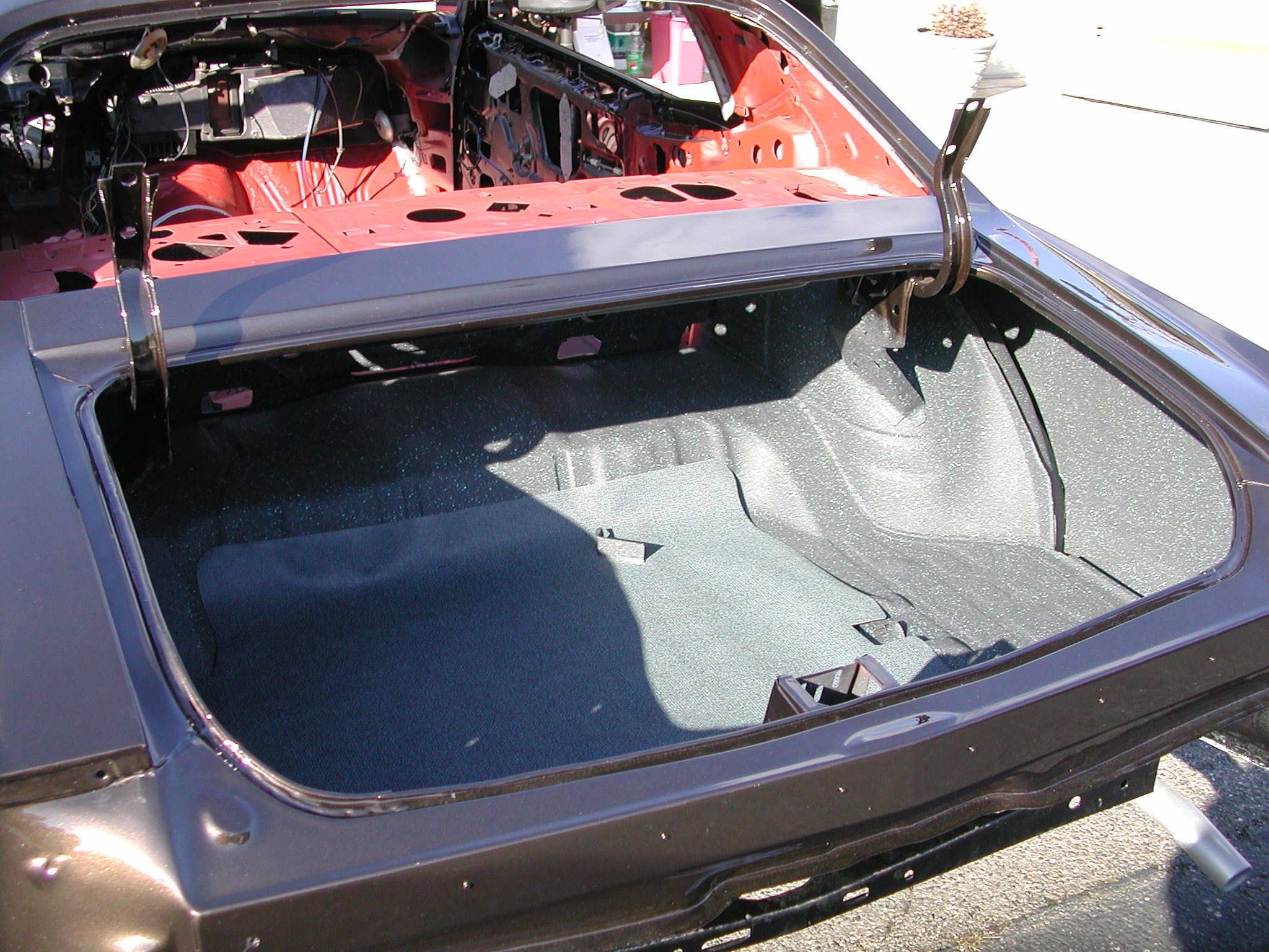

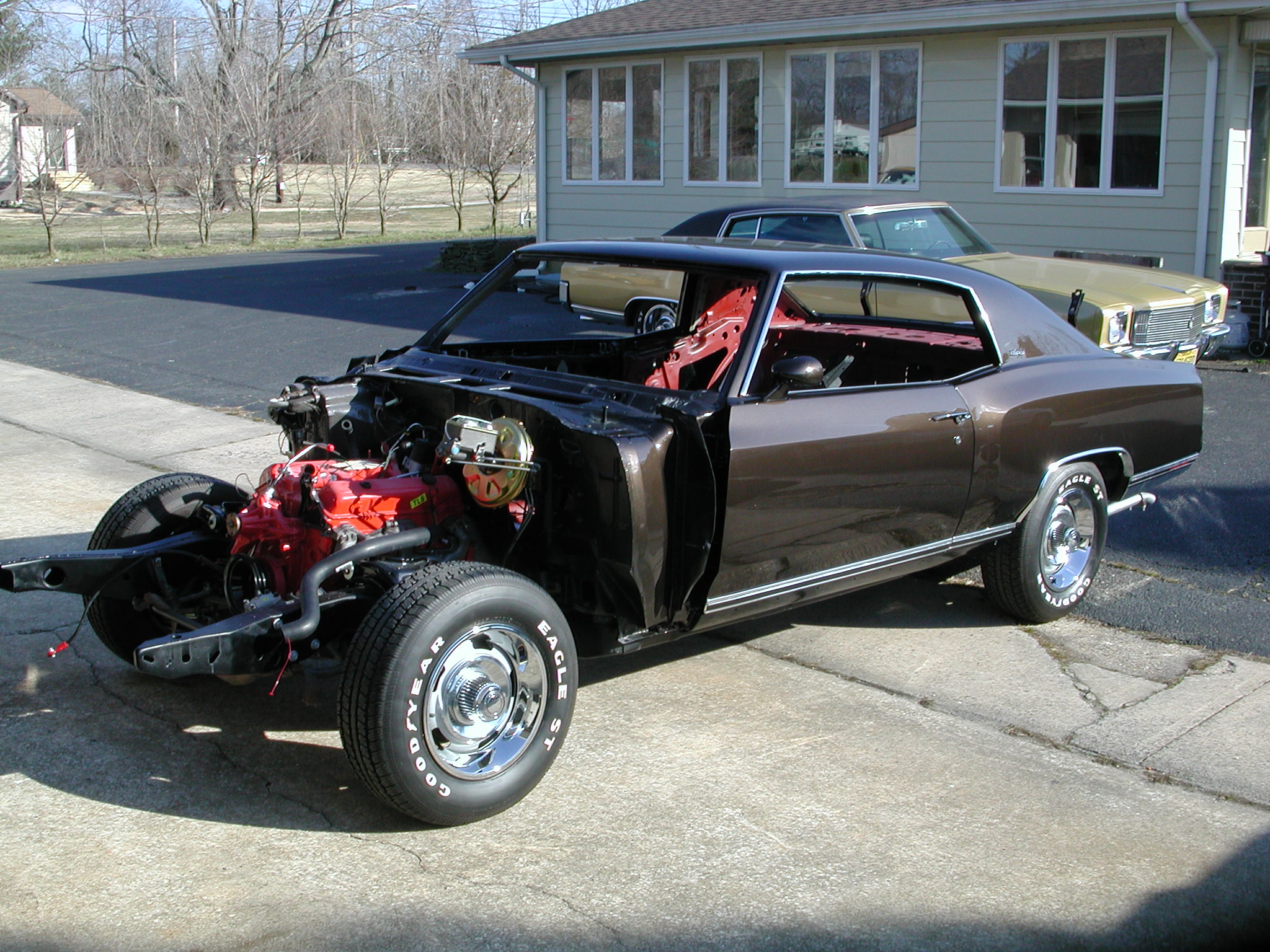

Just used the &quot;Berlage&quot; paint on my 72 Monte Carlo this weekend with a Devilbiss Finish Line HVLP gun with a 1.8 tip.
Got the paint for $69 from &quot;The Parts Place Inc.&quot; Had to do it twice, as the first quart must have frozen at some point and was the consistancy of oatmeal.
Highly recommend laying down a black base first.

Dave sweet looking Monte Carlo's. Not easy to get those that straight. Can you take a good close up of your trunk paint for comparision.
It looks great. George
