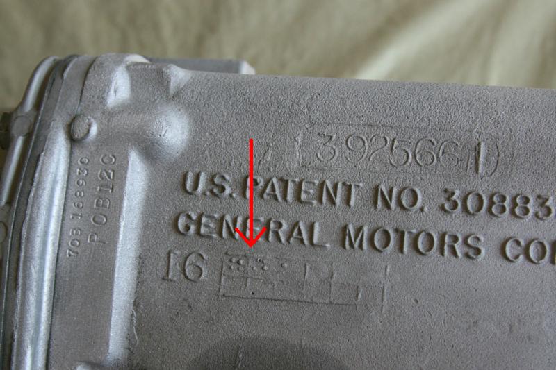

Trans build date (P0B12C) 2nd week of Feb., but the main case was cast the 1st week March...
Nice trick, build the trans before the main case was cast... (and they used the wrong font)

Just curious...I see the assembly date stamp, but where is the casting date??
Thanks..Tom

where the arrow is pointed.
