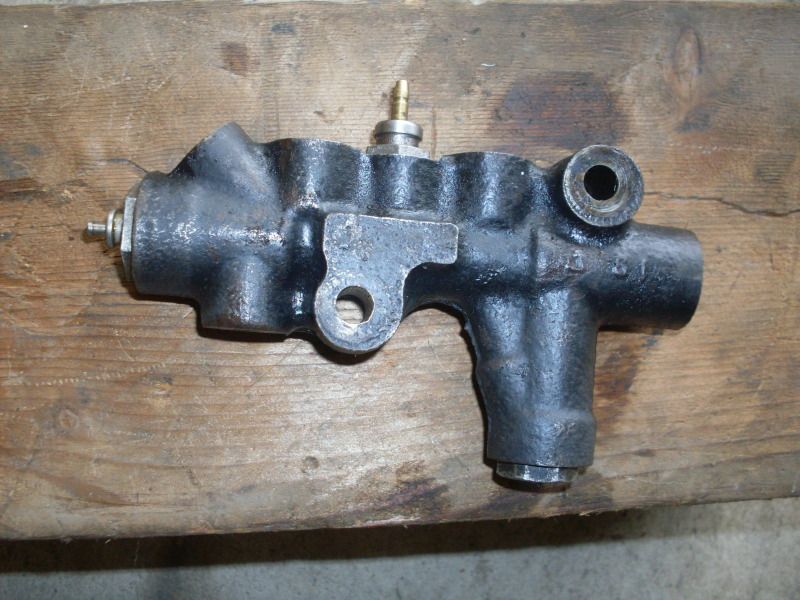

Great info! Do you offer the parts/o-rings for the other versions of the combination valve? This is the one from my 72 Firebird. There is also a similar cast iron bodied one that does not have the &quot;L&quot; shape.

<div class="ubbcode-block"><div class="ubbcode-header">Originally Posted By: njsteve</div><div class="ubbcode-body">Great info! Do you offer the parts/o-rings for the other versions of the combination valve? This is the one from my 72 Firebird. There is also a similar cast iron bodied one that does not have the &quot;L&quot; shape.</div></div>
I do. I currently have two kits (proportioning and pressure differential) available for the Kelsey-Hayes valve you have pictured. Here's the disassembly article:
https://www.musclecarresearch.com/19...-valve-autopsy
I'm still working on the kit for the metering valve and that's what's holding up a rebuild article. If you can't wait assembly is just the reverse of disassembly. These are the seal kits:
https://www.musclecarresearch.com/kh-iron-combo-kit-1
https://www.musclecarresearch.com/kh-iron-combo-kit-3
I hope to have a kit for the metering valve &quot;soon&quot;.
