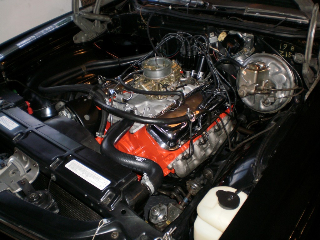

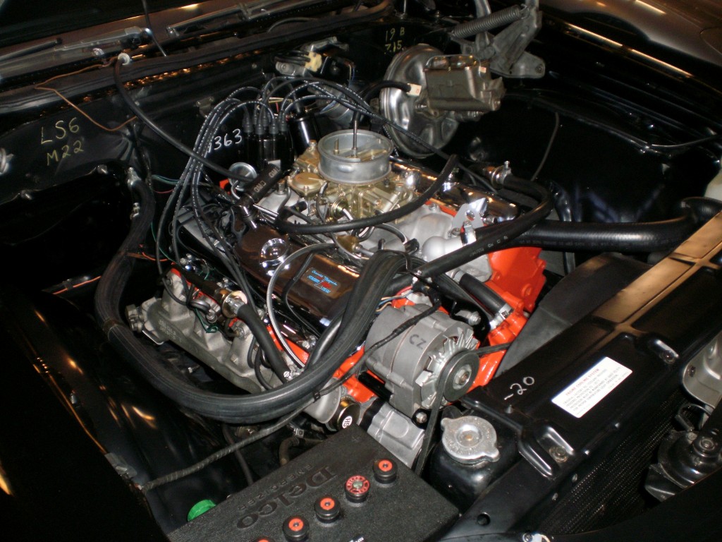

Still waiting for my motor builder to come by and do a break in. Maybe Friday or Saturday [img]<<GRAEMLIN_URL>>/no.gif[/img] It sucks to wait.
In the meantime i hooked up the spark plug wires, filled the antifreeze, put in the oil and primed the oil pump shaft and hooked up the battery to see if everything was fine.
Car has been sitting for a few days and no leaks to be found underneath.
I hope all goes well when we turn that ignition on.
My patience is getting thin.
Here is a couple of photos with the motor ready to go and complete.
Not bad for a Canadian AY.
Next reply i will let everyone know how the break in went.
