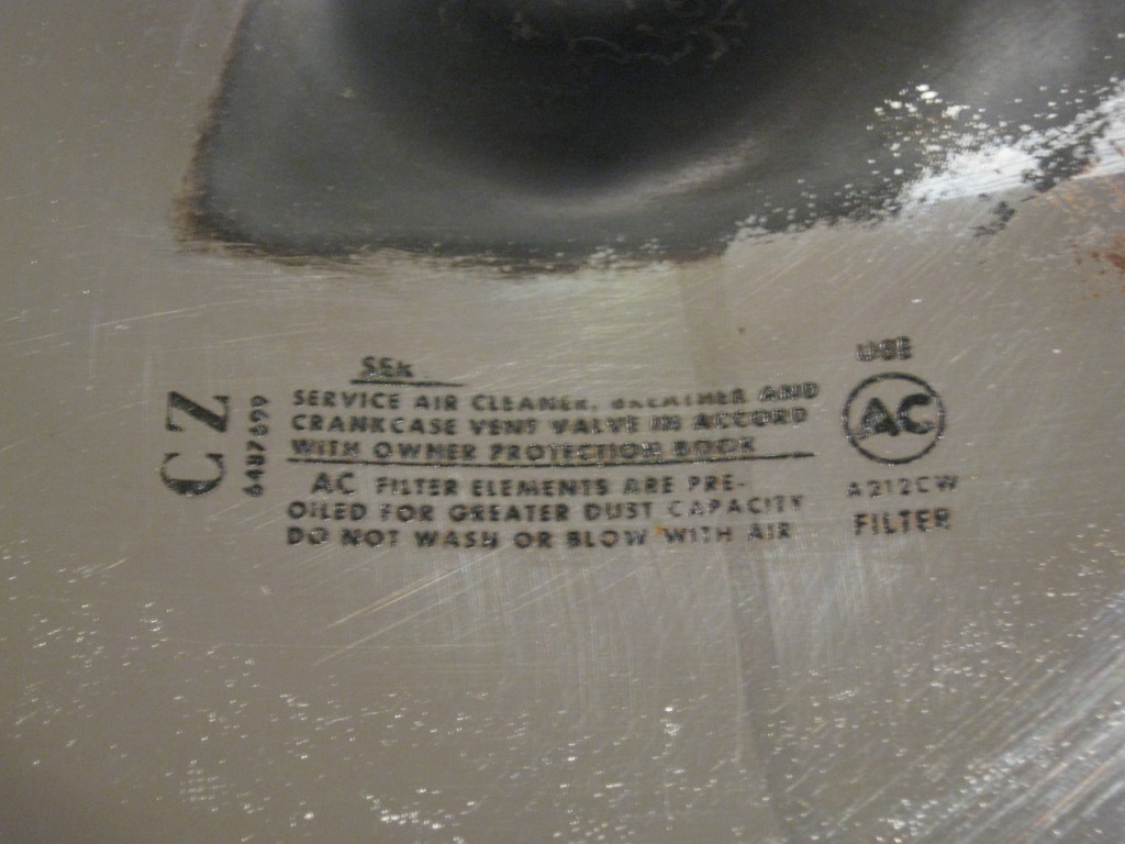

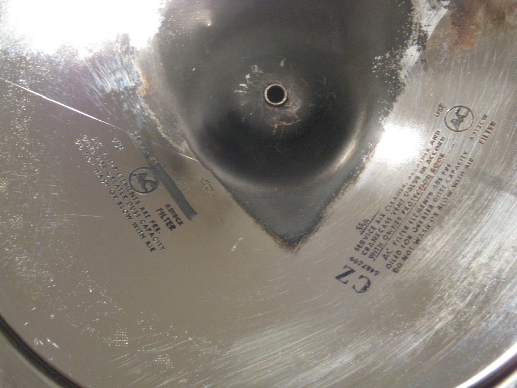

I cleaned it up some with some gas and manual labor.

<div class="ubbcode-block"><div class="ubbcode-header">Originally Posted By: 68SSCamaro</div><div class="ubbcode-body">I have one from a swap meet years ago with CZ and 6487699 on the side of the silk screen and there are 2 silk screens. It's pretty black so hard to take a photo. Any clues on what year?
Martin </div></div>
Martin...That's a 1973-74 Z/28 <span style="text-decoration: underline">ONLY</span> Camaro air cleaner base.
&quot;CP&quot; was an open element air cleaner.Same as &quot;SS&quot; code.
