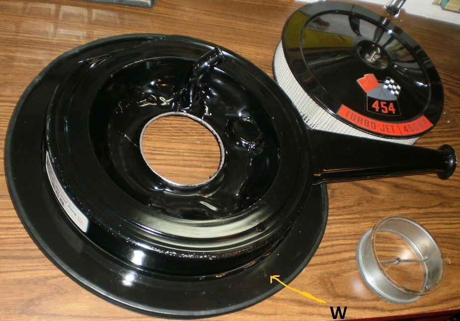

I Had this on file off my original LS6 70 Chevelle.
Hope it helps.

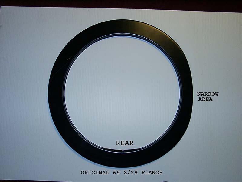

I hate to differ with Rick, but the 69 Camaro assembly line flange is egg shaped, not round. If you stand in front of the car, and look at the engine bay, it is round from about 11 o'clock to about 7 o'clock, with a consistent width between the inner and outer circle, but with from 7 to 11 is thinner, giving it the egg shape. This flange is being reproduced, too.

69 Camaro flange looks like this.
John Brown
