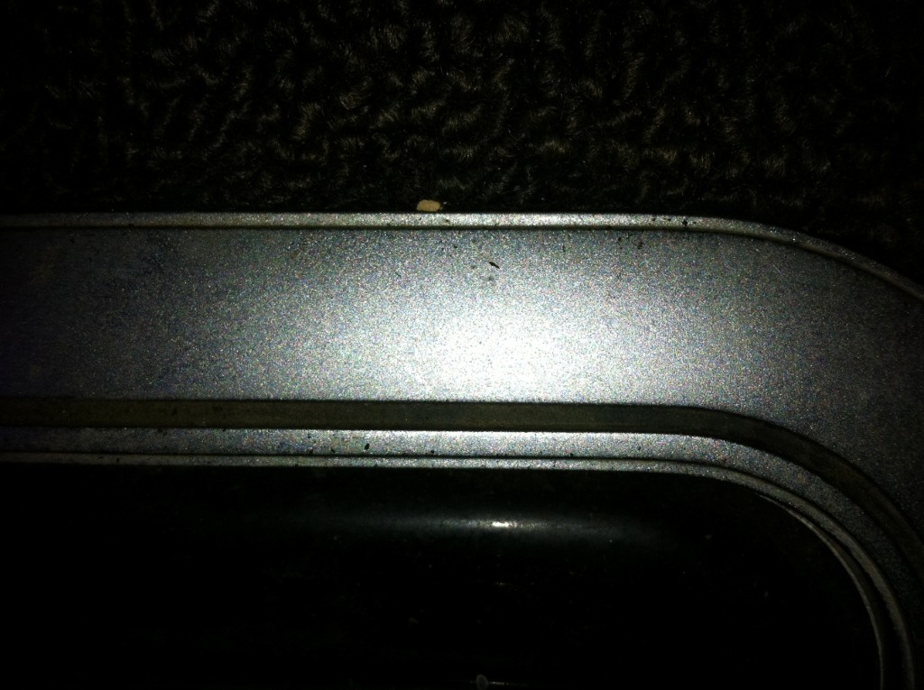

Hi folks, someone painted the shifter bezel on my Chevelle and I want to strip the paint without harming the original finish underneath. Is this just a matte finish chrome, and can I use paint remover without risking marring the original finish?

Mine is a natural, matte finish that I polish when needed. Except for the black inset, I don't think it was painted, and don't think it was chromed.
Will laquer thinner take the paint off?

mine looks like a silver type paint ?

Thanks guys. I used lacquer thinner to get some of the paint off. The tougher stuff I scraped lightly with a razor blade. I think the original finish was supposed to be a light silver dusting of paint like Charley's pics show. Now mine looks like a semi-shiny chrome so I might hit it with some light silver.

I couldn't decide how to restore mine. Finally, I had it re-chromed and then I painted the inset black. The chrome was kind of a matte finish because of the rough surface. Looked really nice.

Charleys pix jive w my original interior 32k mi '69 Chevelle bezel bench seat no console.
