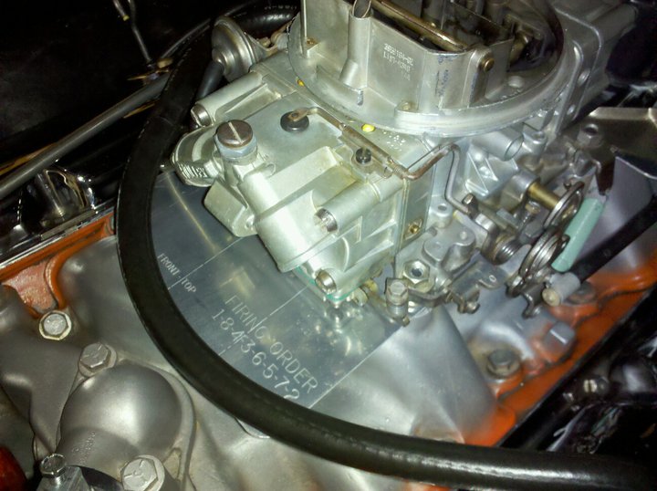

Here's the setup from my NA9 equipped 1970 Z28. On a Camaro equipped with NA9,there was a special Holley carb which had a vent line attached to the front of the carb from the charcoal canister, and a special carb heat shield that was exclusive to the LT1 Z28. Note that it is shaped quite differently than the heat shields that came on some Chevy big blocks.

Al...It appears that Willow Run started using this hose in or around Jan. 1970 by the revision date. It may have been a short lived hose as I have never seen one before. Maybe someone has a Chevrolet News bulletin on these hoses that can shed light on them. They were probably more expensive to have made than the time it saved them on the assembly line to install the plastic "T" style and clamps. I was curious if any of the 1970 Camaro and Chevelles may have ever showed these hoses in their assy. manuals. Green Z your carb is very similar to mine but the heat shield are definetly different. I heard the Z heat shields are very hard to come by.
