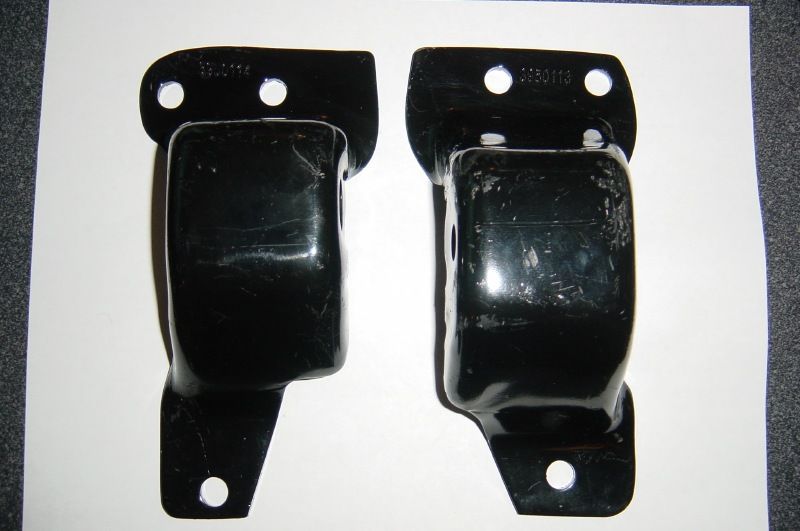

On my 68 Camaro the BB frame mounts are approx 2-5/8 wide the motor mounts are 2-3/8 wide and the application shows 68-70 but are not correct at all, When I did the conversion to BB on my 71 Nova I used 69 Camaro frame mounts and the same motor mounts I have now and worked great. Im sure someone has had this problem any clues on a correct motor mount?

This might help. GM discontinued these a couple of years ago. I would check with your local GM dealer some one may have them on the shelf. I went through the same problem with my 68 L78 Nova.

For reference,
Top 3912598 RH &amp; 3912597 LH 67-68 Big Block engine frame mounts.
Middle 3980942 RH &amp; 3980941 LH 69-70 Big Block engine frame mounts.
Bottom 3980938 RH &amp; 3955183 LH Small Block engine frame mounts.

what do the frame mounts in your photo go to? nova or camaro?
