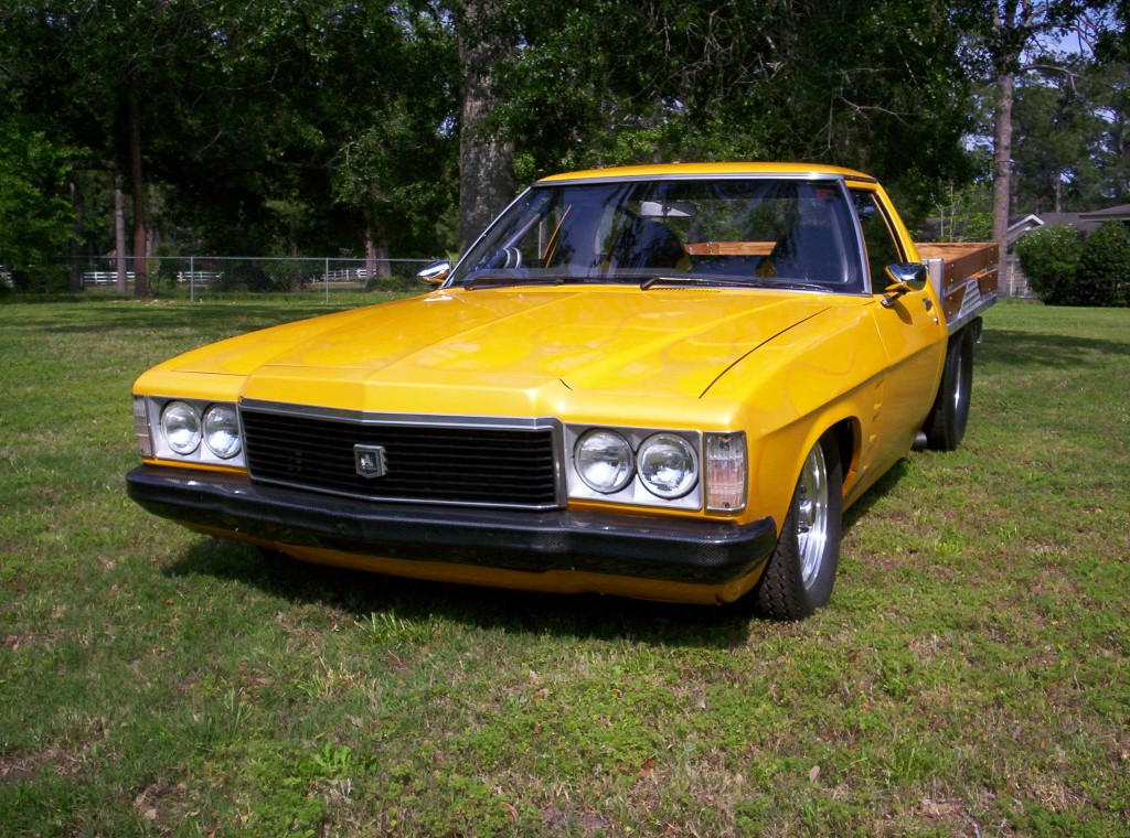

I had a 1968 HK Monaro 186 cubic inch 6cyl 4 speed that I got for my then wife.
I have built many for others and came oh so close to buying a mint 350 HQ 4 speed one time. Tried to buy one before I came here but those available were too expensive instead I brought over a HX one tonner (cab chassis) that I have built into a super gas/pro street car.
