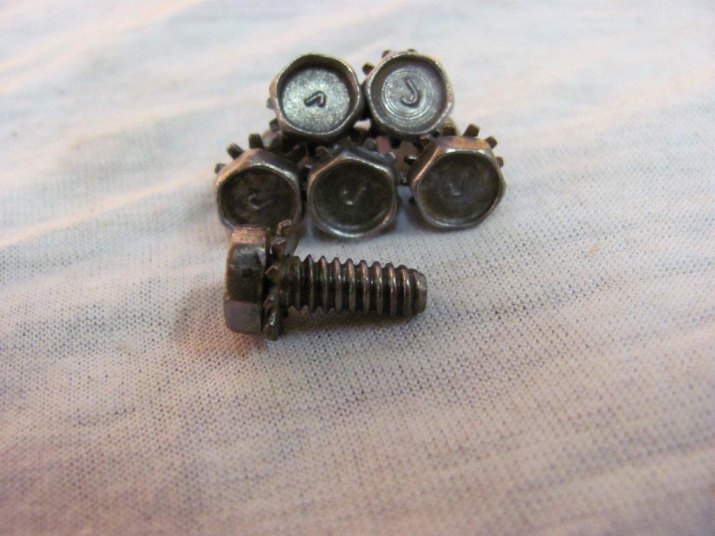

10-24 thread 1/2" long 5/16" Recessed Hex head captured externally toothed star washer.

Got an image of an original one of these that you can post?

Hey Steve,
sure thing. Typical headmarkings are J, L and RBW.

Definitely 6-24. Here is the set Rick's sells, but they don't say whether they are technically correct. I removed some from a pace car 25 years ago, and they were allen head, but no way of knowing if they were originals, as the car was already 16 years old.

Definitely 6-24.
Doh! Must have been late. Of course, I meant definitely 10-24. Man, gotta get some more sleep.

Here are a couple pics of my original cowl screen screws.
