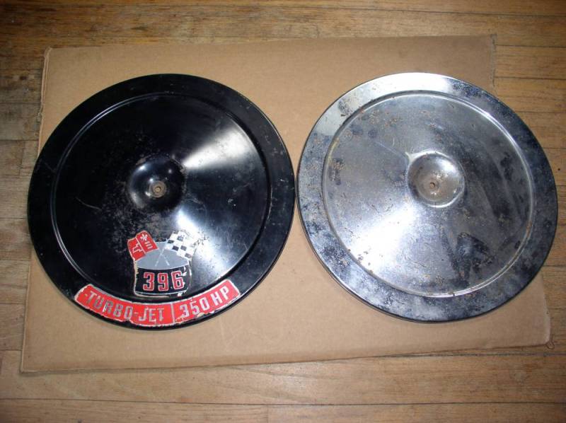

Chevrolet parts catalog dated 1970 list the 6422356 and 6421832 air cleaner lids
6422356 (lid)
65-66 Corvette (396) (w/ 6421816 air cleaner)
67 Camaro (396) (w/ 6424434-35-36 air cleaner)
list price 8.70
6421832 (lid)
66-68 Pass, Corvette (327,396) (w/ 6421963-2286--7-3240-69-3520-3689-3907-8-9 air cleaner)
66-69 Chevy, Chevelle (327,396)
67-69 Camaro (396)
All (w/ 6423269 -3908-64836-56 air cleaner)
69 Pass w/ Spl Hi/Per (427)
(w/ 6423907 air cleaner)
list price 16.75
Above information shows both lids used at the same time for service replacement lids
- black lid w/ list price of $8.70
- chrome lid w/ list price of $16.75
Both lids are listed in 1974 parts catalogs also

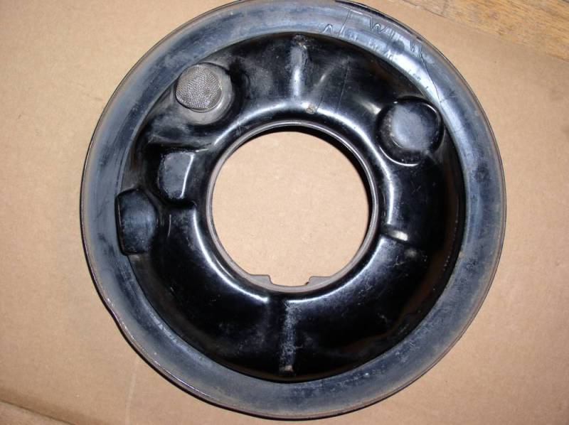

I recently purchased this air cleaner http://cgi.ebay.com/ebaymotors/ws/eBayIS...=STRK:MEWNX:IT. I am sure that the base is original but would like to know how to determine if the lid is correct. Thank you for any info. Tom.

Pic #1
1966 Passenger Car & Corvette parts catalog does not list 6422356 lid as chrome at $7.10
Pic #2
1970 Passenger Car Chevelle Nova Camaro parts catalog shows the diferrece in prices between 6422356 black lid at $8.70 and
the 6421832 chrome lid at 16.75 also used on the popular 1969 Camaro Chevelle Nova Impala 6423907 open element air cleaner
