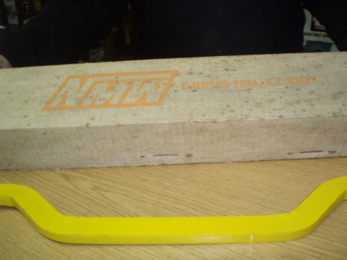

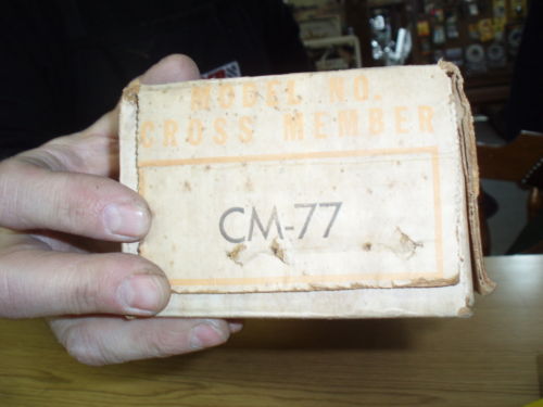

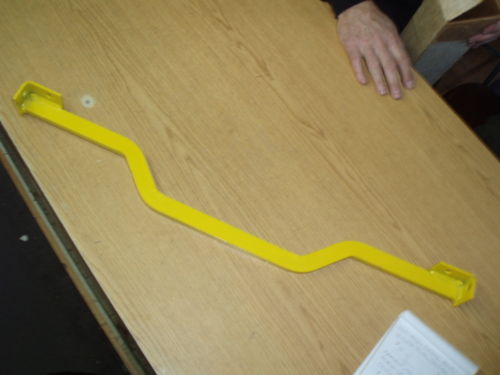

Ok guys please school me on what issues I'm going to have running ladders bars on the 68 Nova. I picked up a set of NOS NMW ladder bars. I have them installed but it really pre loaded to springs. Theres not much movement just pushing on the back of the car checking the spring flex.
Note: This car is weekend cruiser to work and a few car shows. Thanks for any input in advance.

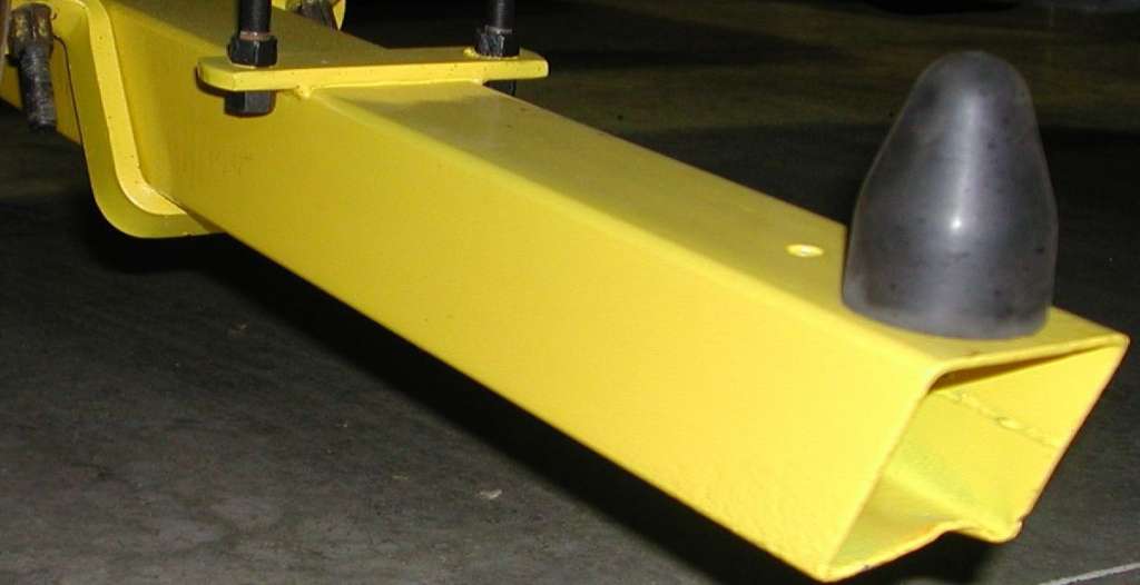

I believe the correct Lakewood bar would be the Traction Action. We have an original set on our 1970 TH400 L78...here is a pic.
