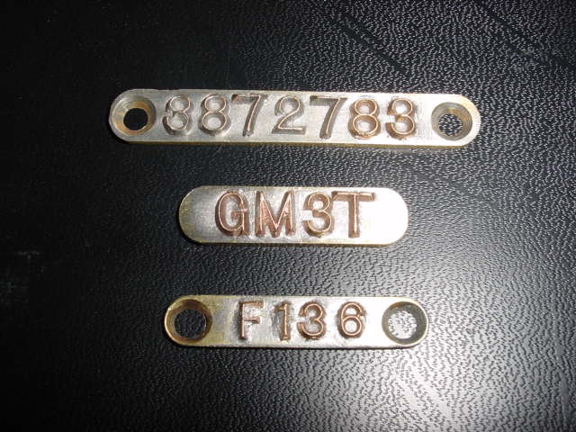

Old 10-10-2009, 04:55 AM
JohnZ JohnZ is offline
Join Date: Jul 2005
Location: Washington, Michigan
Posts: 157
Thanked 2 Times in 1 Post
Default Re: 291 Head Differences
To be more precise, high-volume castings had multiple PATTERNS (made of cast iron or stainless steel); when sand was packed around the pattern, it created a sand mold. The sand mold was opened, the pattern was removed, and the mold was closed. Iron was poured in the sand mold, and the sand disintegrated on the "shake-out" table after cooling, when the raw casting was removed.
Each pattern was numbered and carried the casting number, casting date and hour clock; that appeared on each casting, and enabled internal traceability in the foundry back to the pattern in the event of a problem with a casting.
The casting number, casting date, and pattern number were individual brass characters soldered to a brass plate that was pinned or screwed to a recess in the pattern; the date tag was changed every day, and the clock tag was changed every hour. Photo attached of tags from the Saginaw Foundry.
