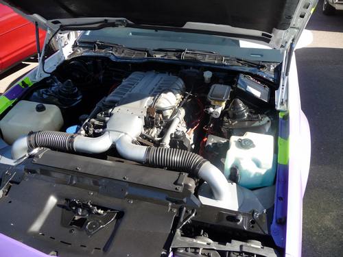

I was trying to buy a IROC at Barrett-Jackson Scottsdale that had one of the LT5's. They do fit but hard to believe that car had it. Somewhere I have pics.

I saw this car at Carlisle back in, I think, 2001 or 2002. It was on display with many other GM-owned Camaros as part of a Camaro Heritage Tour (or something like that).
