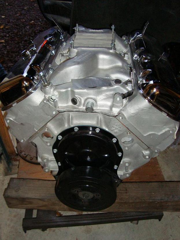

Im thinking that I have all the right stuff....anyone?? I bought most of these parts so long ago, I havent even checked the numbers...they werent making so many fake/repo parts back in the day!! Im really not sure on the t.i.ignition stuff..
BTW, we did not use the NOS cam and lifters as more than one person told me to use a newer cam as they are much better, although I got a cam with the exact ZL-1 specs.
I wonder what power these motors could make with a good match porting and a roller cam???
this is the last pic before the dyno!!!

Coil...(is this correct??)
Later model GM replacement, original has embossed 207 or 176 number, not painted number.

Thanks John, bummmerrrrr on the coil....I cant imagine how much one is nowadays....how about the amp??? (I put wrong pic)
And the pistons were stock ZL-1 specs, but Im sure the heads may or may not have been shaved at some point...and the head gasket thickness??? The combustion size??? I would just be guessing to tell you the truth...

343 is the correct amp.
More accurately, I was wrong on the coil. It was #210 from the factory.
Transistor Ignition Coils
TI systems use a special ignition coil. These coils have lower impedance than the standard ignition coils and are capable of flowing much higher current. This allows them to make a hotter spark at high RPM ranges when the spark plug voltage requirement is higher. If a standard coil is used, it will not be able to generate sufficient secondary voltage to work properly. Though there were several TI coil numbers, only two pertain to use on the Camaro. Part # 1115207 was the coil used for all OTC systems. (Photo 7) Part #1115210 was the exclusive coil that came from the factory on the 1969 ZL1 Camaros. The only number available as a service coil was the #1115207. The “210” could not be purchased at the dealer.
Here's the whole article in the T.I. ignition.
http://www.coloradocamaroclub.org/trnsignrevision4.htm
