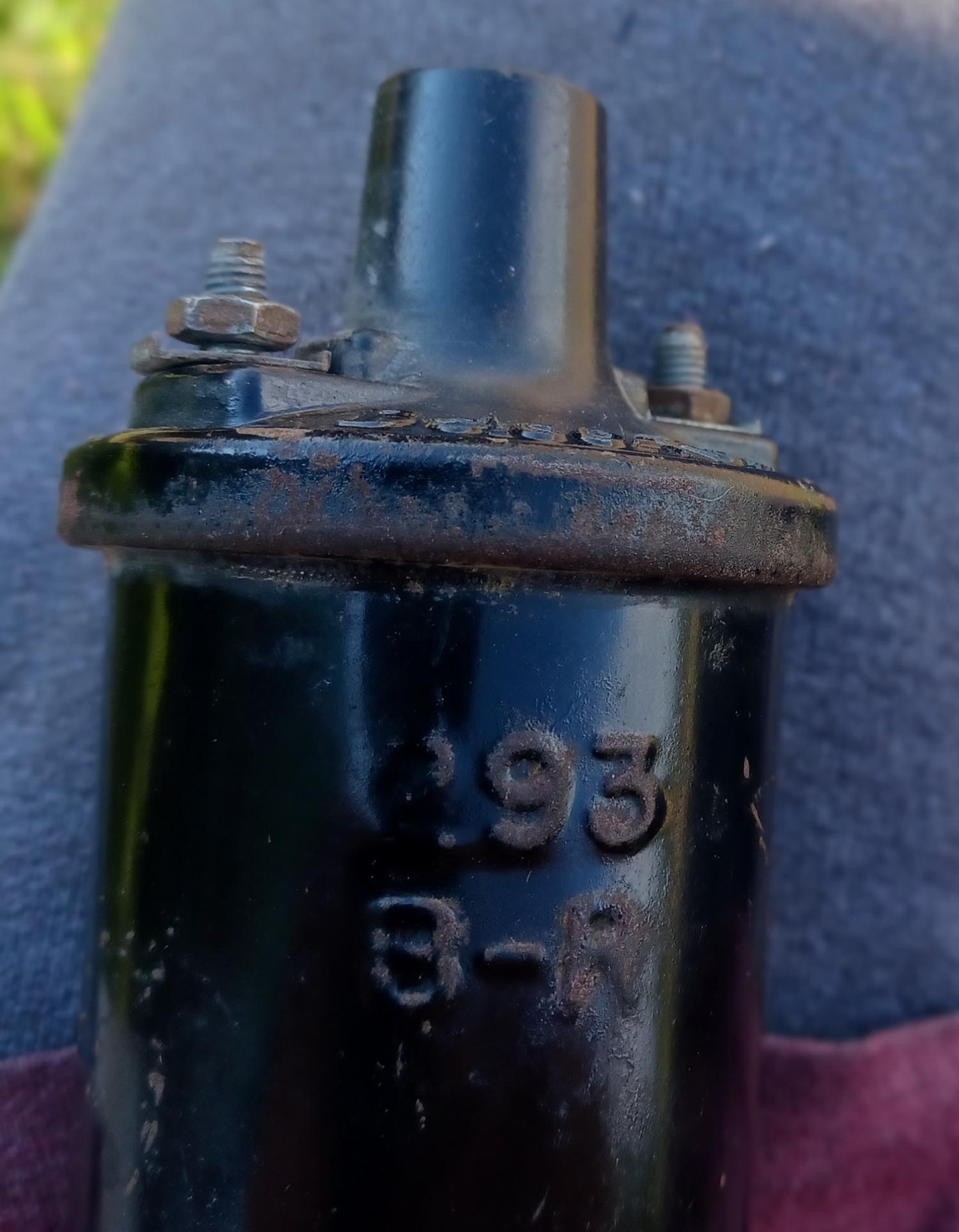

The legends judging manual lists the 293 for all big blocks. Very early cars used the 293 BR, later 293 B-R.
The 270 coil is for L48 and Z/28 w/ducted hood; bracket is different.

Pic of a 293 B-R
